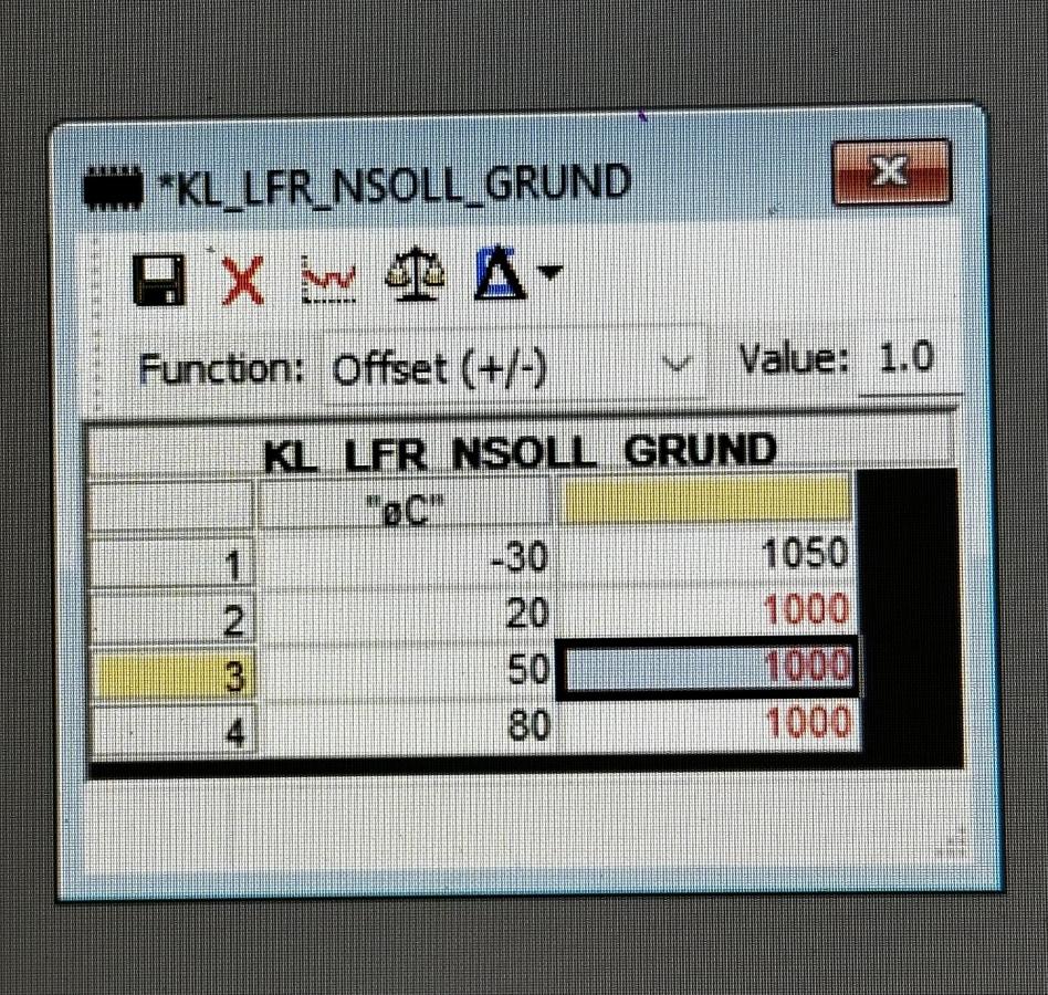

                    Basic procedure is as follows:
                    • Read out tune using MSSFlasher (recommended), BMWFlash, etc.
                    • Edit idle values using TunerPro or the ECUWorx Binary Modification tool and save new tune
                    • Flash new tune onto car
                    To edit idle using the ECUWorx Binary Modification tool see here: https://www.ecuworx.co.uk/how-to/usi...fication-tool/
                    To edit using TunerPro, grab the XDF that matches your tune from here: https://github.com/saildot4k/MSS54-X...omplete%20XDFs and load into TunerPro. Then look for the KL_LFR_NSOLL_GRUND table and modify as you wish. Since you're targeting 1000 rpm idle, you likely want to change all but the -30C value to 1000 rpm.

                          Thanks for the help everyone, I truly appreciate it! It looks like I was successful with TunerPro and even deleted a pesky code that’s been irritating me. Played around with ECUWorx a little and that user interface is definitely much easier to navigate but not wanting to spend anymore money (plus delete a code) I decided to figure it out on TunerPro.
