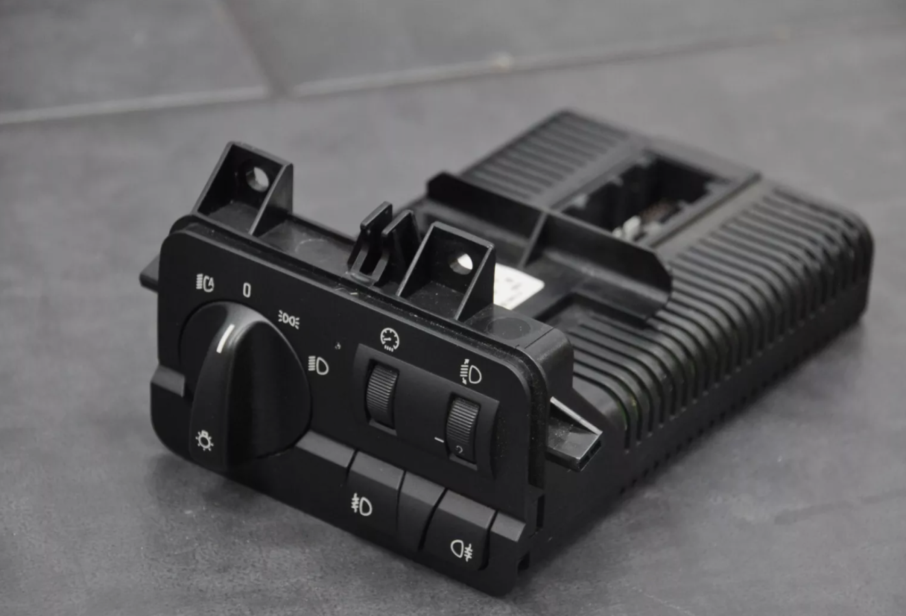

    As the title states, I have been keen on doing a manual vertical aim control retrofit on my E46 Coupe w/ factory halogens.
    AFAIK, this seems like a pretty straight forward retrofit (please let me know if I am leaving some steps out):
    • Acquire and code new lcm w/ aim control feature
    • acquire stepper motors/source euro halogen headlights
    • wire motors to LCM harness
    • job done
    I do have one question though: Do ALL halogen equipped euro spec 3 series come standard with vertical aim control? In other words, If its not a xenon car, will the car automatically come with halogen lights w/ manual vertical aim control?

    So a US halogen car has no way to adjust the headlights?
    And yes, all euro halogen cars have the little wheel.
    I am sure you have researched this, but I would just start by just changing the LCM, I think the wiring and hardware in the lights might already be there? I could be completely wrong of course.
      The only way of adjusting the headlights for a USDM car are the knobs on the headlights themselves. I remember taking apart a set of US halogens and finding the stepper motor missing. So either, I buy new vertical aim stepper motors to integrate into my current headlights OR source euro halogens with the vertical aim motors already installed.
