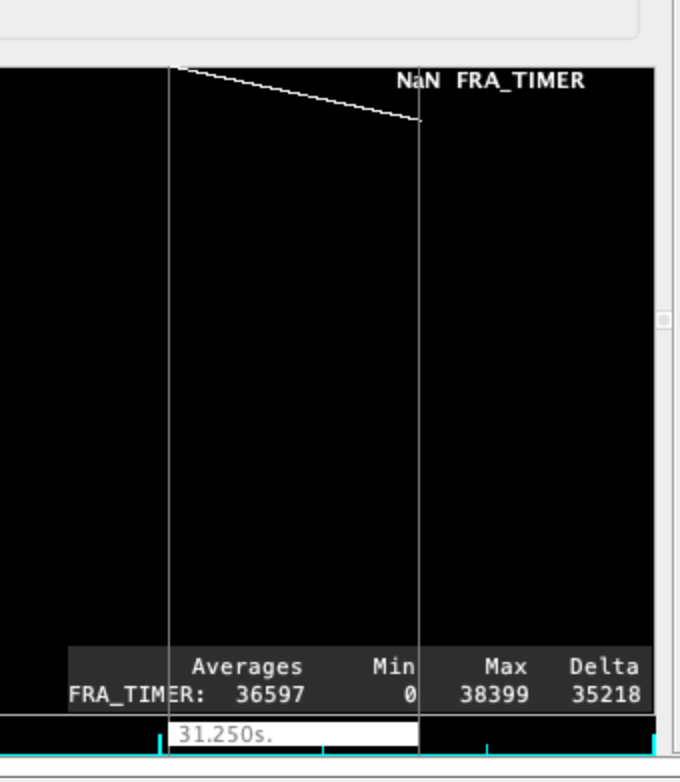

      I verified this via logging:
      Here is FRA_TIMER (as you can see I gave up watching it decrement after 30 seconds)

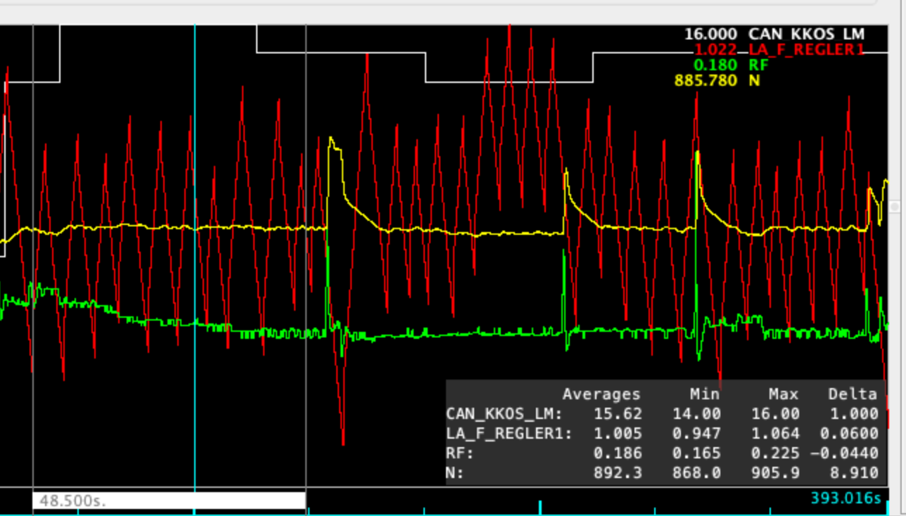

      So, will this solve my aircon/lambda issue? I'm not sure. I need to log for a while in different conditions to be able to say for sure, however I will say that my initial quick check seems promising:
      Aircon compressor running - average lambda of 1.005

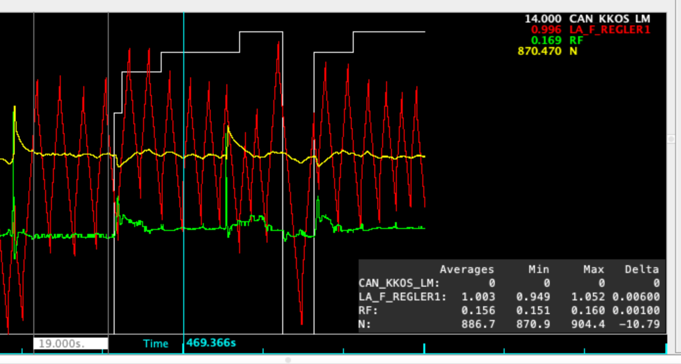

      Aircon compressor off - average lambda of 1.003
