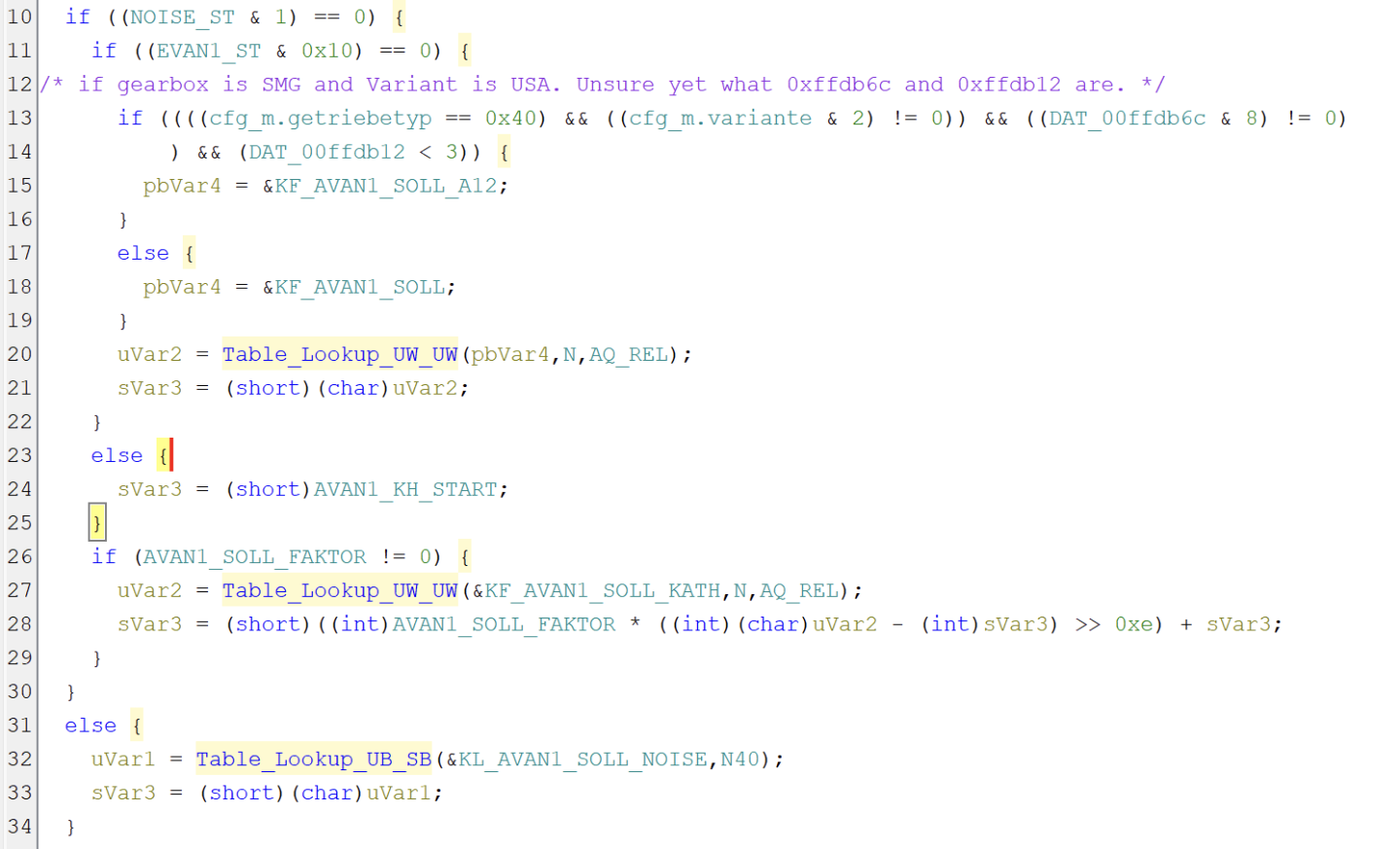

      FWIW this is the relevant code snippet for the AVAN (exhaust) calculation:
      Click image for larger version  Name:	Screenshot 2025-01-05 at 2.12.34 PM.png Views:	0 Size:	204.5 KB ID:	289396
      Essentially it gets the relevant AVAN_SOLL (target) value based on a few conditions (interestingly there's a separate table for US-spec SMG cars under certain conditions which I haven't completely figured out). It the checks whether AVAN1_SOLL_FAKTOR (a factor looked up from TMOT, etc.) is zero (car is warmed up) and if it isn't (car still warming up) then it looks up the AVAN1_SOLL_KATH value, subtracts the "SOLL" (target) value from it (to get the difference) then multiples that by the AVAN1_SOLL_FAKTOR to get the level of adjustment that needs to be made to the "SOLL" value.
      Essentially it blends between the "SOLL" and "SOLL_KATH" tables based on how warm the car is (simplifying the explanation here but that's the gist of it).
      Note that there are some other various conditions where other values are used, but once the engine is running and warming up as usual the above is how it works.
