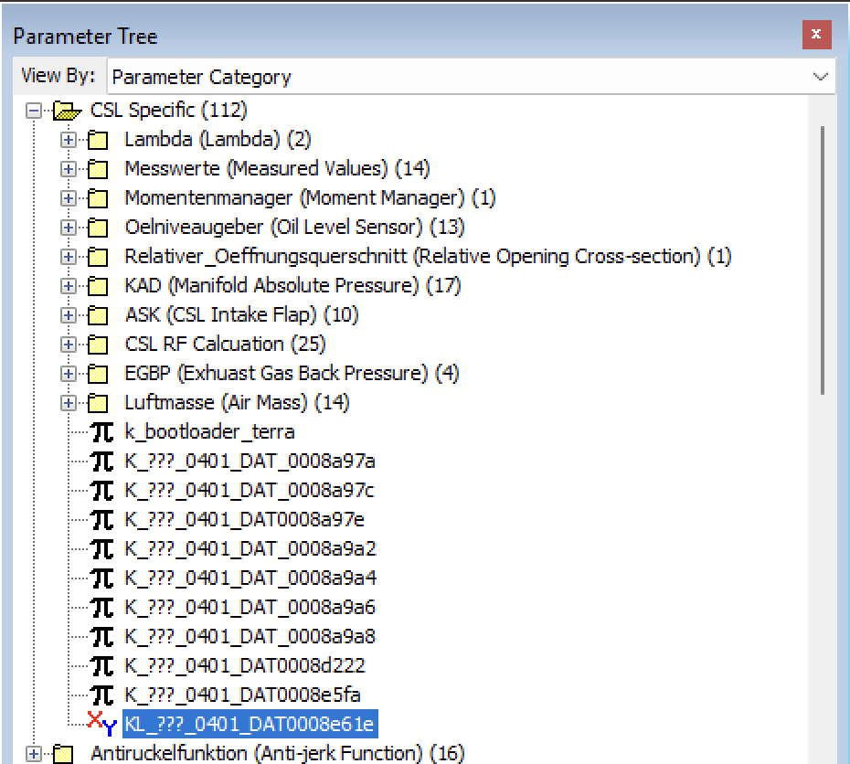

    Key things to note:
    The CSL-related parameters are grouped together, and are now split out into subcategories to identify the module that they relate to.
Name:	Screenshot 2025-06-12 at 12.06.24 PM.png
    I've put explanations in the descriptions of the ones I've worked out:
