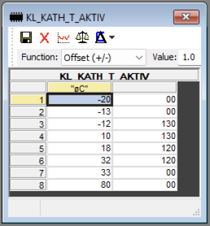

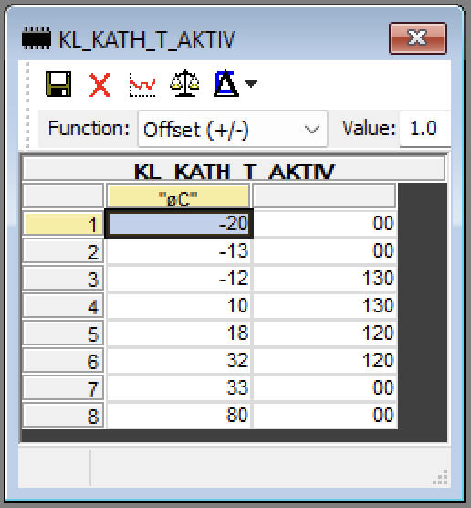

      Cat heating is a separate mechanism. If you want to disable cat heating I believe the easiest way is to zero out the second column in KL_KATH_T_AKTIV

      This table is used to calculate the duration of the cat heating period, setting it to 0 means it never starts.

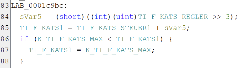

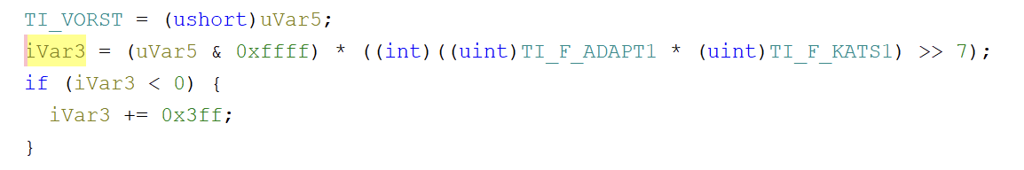

                    TI_F_KATS1/2 is the multiplicative factor for cat protection.
                    It in turn is an input factor into calculating injection time which is a composite of TI_VORST (pre-injection time), TI_F_ADAPT1/2 (adaption factor) and TI_F_KATS1/2 (cat protection factor).

                    That value is then used to calculate injection time for each cylinder. K_TI_F_KATS_MAX therefore limits a maximum increase of injection time by 35% for the purpose of cat protection.

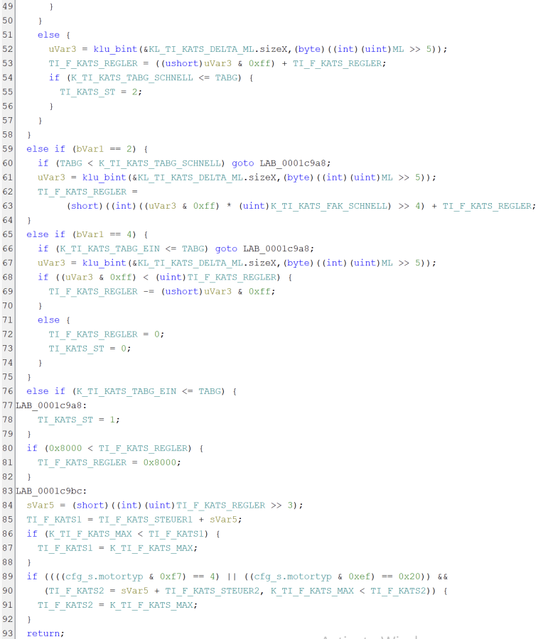

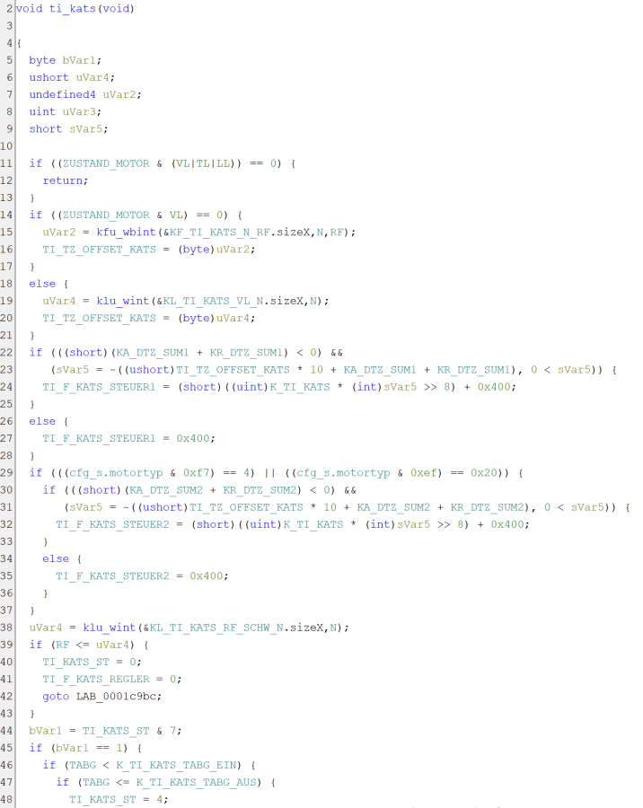

                        Okay - I've had a chance to look into this a bit more fully (disassembly of ti_kats() below).
                        Key things to note.
                        • Ignition IS part of cat protection as you suspected E46m3zcp. It can be seen at lines 22 thru 36 where TI_F_KATS_STEUER1/2 are calculated. This value represents the fuelling adjustment factor as a result of ignition being retarded for cat protection.
                        • TI_F_KATS1/2 is the overall cat protection factor, factoring in both ignition retardation and fuelling increase for cat cooling (protection).
                        What this means.
                        • The correct way to disable cat protection as a whole is to set K_TI_F_KATS_MAX to 1.0. as this is applied to the resultant TI_F_KATS1/2 overall factors.
                        • Disabling the integral controller doesn't disable the ignition-related portion of cat protection.

                          Originally posted by SliM3 View Post
                          You can also disable the whole EGT config if you want to do without the sensor.
                          I'd just note that for anyone running the CSL software (0401) they should not remove the EGT sensor or disable it as it is an input to the air-fuel mix (rf_korr) calculation (Only for the CSL, not for normal M3 software).
                            What you have pointed out above in your disassembly is the feedforward function that is enabled when ignition is retarded due to knock control (kr_dtz_sum[bank 1/2]) and knock adaptation (ka_dtz_sum[bank 1/2]) not cat protection. Knock is a clear indication that EGT is on the rise and the resulting feedforward factor is essentially a request for additional fuel enrichment from the cat protection routine. So in a nutshell, instead of the DME waiting for the EGT sensor (100ms loop) to detect temp rise it uses ignition retard as the early warning signal and the offsets for calculating a positive or negative threshold & ultimately the feedforward factor: Knock detected > Timing retarded > EGT expected to rise > Add a small amount of enrichment immediately > catalyst temperature under control.
                              Yes I'm aware of that, the point though is that it IS part of cat protection (part of this function). The knock control is used as a feedforward input as you say. TI_TZ_OFFSET_KATS (lookup from RF in partial throttle mode and from N in full throttle mode) is the factor that is used to determine how much additional fuelling is needed. kr_dtz_sum and ka_dtz_sum are just inputs to the calculation of the total amount of cat protection enrichment required, which is delivered via the two mechanisms as you say (feedforward + integral controller).
