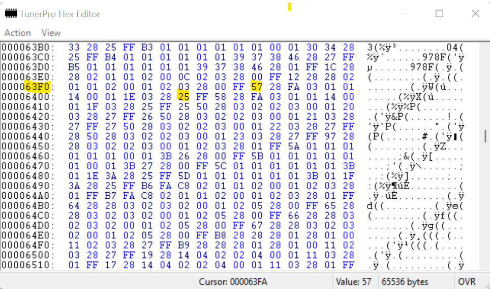

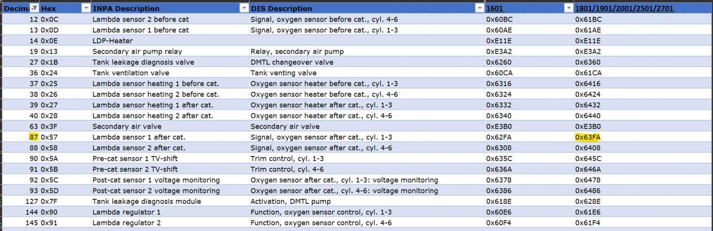

                        How do you exactly do this, what do I have to use/where do I have to go, I have inpa and the other programs installed. Or do I need something else? I’m going through the same issue with my car of it not passing smog, car runs perfect no cel, nothing, just doesn’t wanna get ready.
                          Let this go for a while and now trying to learn/work my way through the decimal list using method 1 in Tuner Pro and the excel file from saildot4k.
                          Any chance someone would be kind enough to tell me if I'm on the right track here?
                          In the example below, I am working on decimal 87, Lambda sensor 1 after cat. Signal, oxygen sensor after cat., cyl. 1-3. For my version, 2701, the location listed in the file is 0x63FA.
                          My cursor is on that location, highlighted as 57, and if I'm understanding the process the thirteenth byte needing to be updated with 00 would be 25 just before the FF cap. Or am I just way out in left field🤣
                          Any guidance from those with more experience would be greatly appreciated. Trying to get a bin file ready...just in case.
                          Thanks so much.

                            ^You are correct. I also uploaded XDFs to help you with at least one method.....
                            MSS54 and MSS54HP XDFs . Contribute to saildot4k/MSS54-XDFs development by creating an account on GitHub.
                            TunerPro XDFs, DTCs, A2L, DIY Bench Flash Harness, Swap XDFs COMPREHENSIVE
                              https://github.com/saildot4k/MSS54-X...%20Swap%20XDFs
                              Thank you very much.
