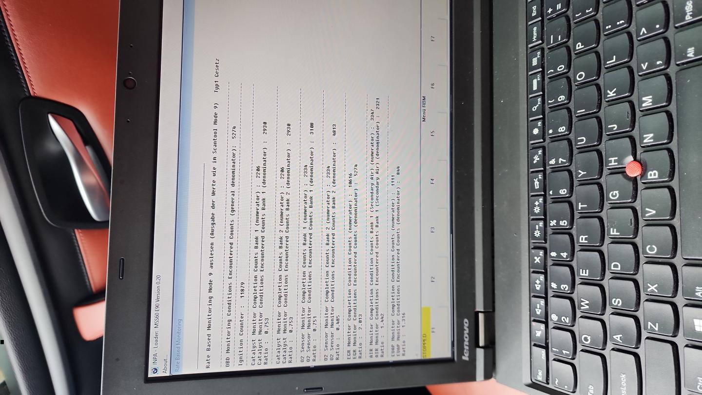

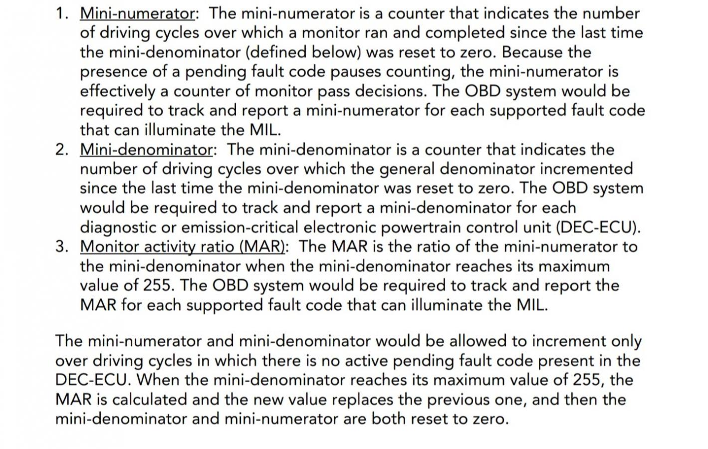

            Anybody figure this out for MSS6X yet? I tried the same method that was used on MSS54 and it didn't work. I suppressed 104 DTCs and nothing. I came across an interesting page on inpa that showed completion condition counts vs conditions encountered counts that calculated to a ratio. From what I can tell, if the ratio is above 1 the monitor will set to ready
