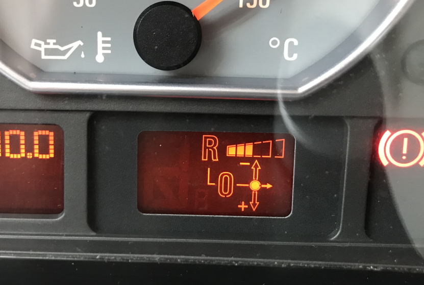

            Here is how my 0x43F message looks like:
            And here is the cluster:

                I've tested the two messages, no gear indicator to be seen.

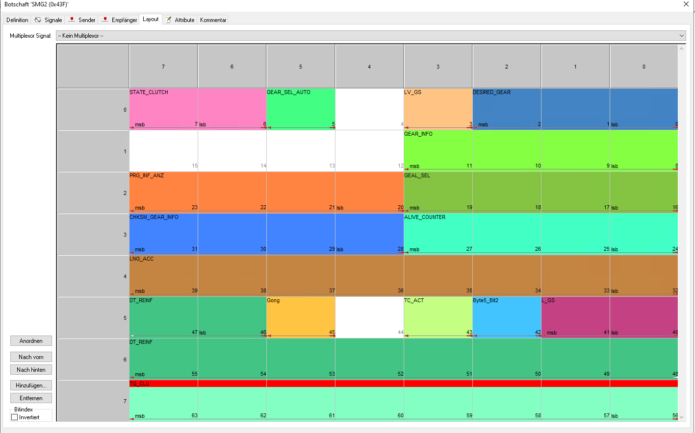

                            Ist pretty similar to my message:
                            Click image for larger version  Name:	grafik.png Views:	0 Size:	69.4 KB ID:	236526​
                            Your Byte3 isn't right, here you have two signals:
                            • COUNTER ( 0x00 to 0xF)
                            • CHECKSUM (COUNTER and DISP_INFO)
                            with 4 bits each. But the order is unknow. I thing lower nibble COUNTER and upper nibble is CHECKSUM, but we will see
