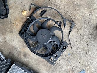

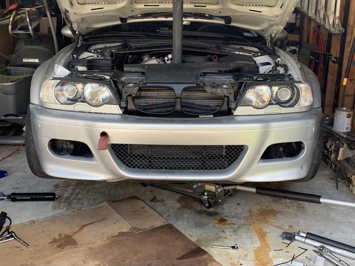

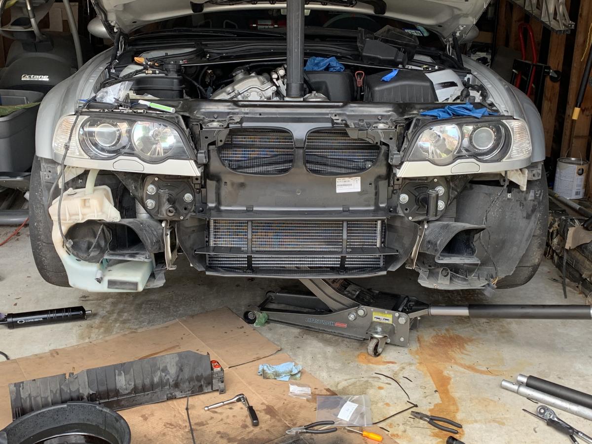

    Hello all, I got into a front end collision on my mostly track car. Slowly transforming into a car that I only take to the racetrack. Long story short, I blew the a/c radiator and all of its compression. If I remove the a/c completely at the front of the car, is there anything I need to be aware of. Do I need this fan anymore? Am I going to trigger a code on the car? Any advice steering me away from doing this also welcome as I’m kinda on the fence about it Click image for larger version

    None really, just delete the AC stuff. If you remove the condenser then you can remove all of the fans. It will cool better on track. In fact removing the fans has yielded the largest drop in coolant temps on track. Just need to make sure you do a good cool down, maybe take a lap around the paddock afterwards. BUT...the coolant system won't need as much cool down.
      Think it's obvious/implied, but removing all fans means no airflow when standing still, so the car will overheat in that situation. Worth taking into account if the car is not 100% a track car just yet.
        Remove A/C completely, remove the fan, remove the mechanical clutch fan and instead install an aftermarket puller fan with controller. So no overheating in paddock and better fresh air flow on radiator

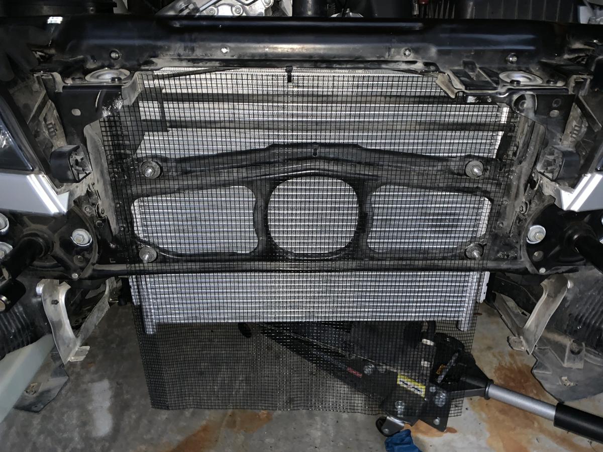

          Do you guys do anything to protect your nice radiator from damage? Like rocks
              I added 1/4” steel mesh from Home Depot. Spray painted black to make it more stealthy. It’s protected the parts against large debris, and there are only a handful of bent fins due to small stuff that got thru, as of yesterday.
              In case you decide to use a fan, I wired my SPAL fan to the aux fan wiring (both stock fans deleted). Works great both on and off the track.
