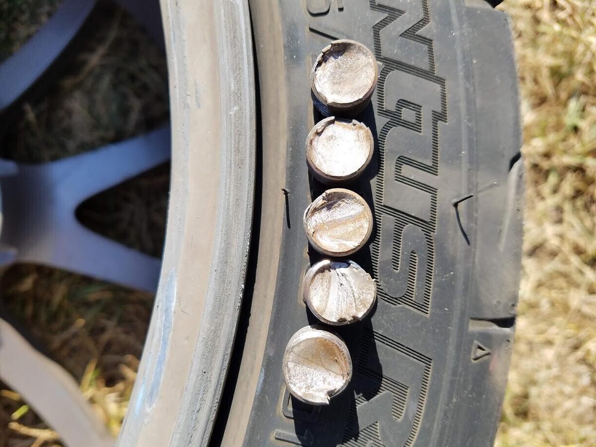

      To the question: You cannot inspect studs for impending failure - short of having a metallurgy lab (in fact I plan to send my current studs to a University metallurgy lab for inspection - arranged by a friend). As noted earlier - studs are wear items. Change them on a schedule. If you wait for failure - you'll get the failure you were waiting for.
      If you beat on studs with an impact wrench, cut your change interval in half.
      After looking extensively at all options - I went with MSI. Buy once, cry once.
      This is what semi-regular impact wrench beating with no torque stick gets. All of these failed mid-turn with costly damage (not my failure/car). Note the internal corrosion on all of them due to hairline cracks.

      The owner didn't do any of his own brake/tire work - so likely both. Shops like fast & easy.

        Definitely a wear item, replace as such. Also a PITA when you have one shear at the track without proper tools to remove
