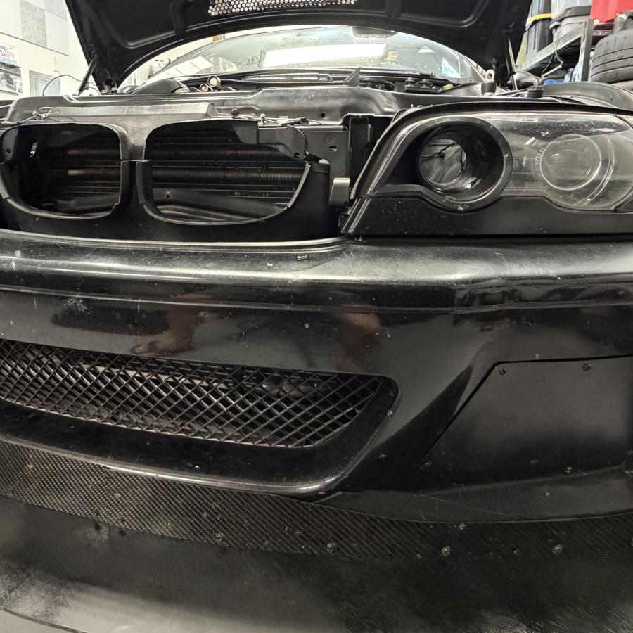

Where would you put the Ambient Air Temp Sensor on this car?
    First, Can I just delete it?
    Would you put it in the headlight duct? (Assume I close it off the opening with wire mesh). That would be relatively simple.

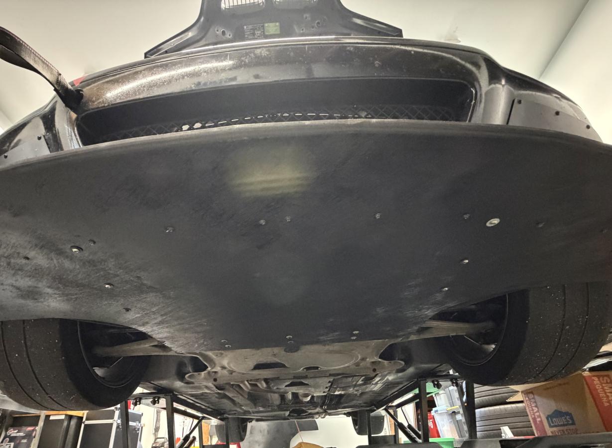

    That’s a plywood splitter, supported by the AJ Hartman chassis mounted kit. I can put a hole in it anywhere if the OEM position is the best place. The challenge under there would be creating a little pocket. I’d have to fabricate that

                  A lot of the newer cars put it in the duct for the radiator, that is where I am planning to mount mine.
