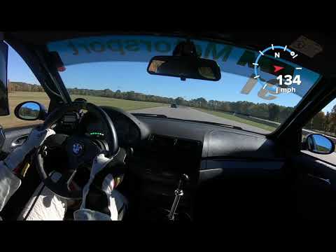

    Here's mine from VIR. Need to sort the suspension out still, curbs are upsetting the car too much.
    Great lap. Gives me something to aspire to! Thanks for sharing.

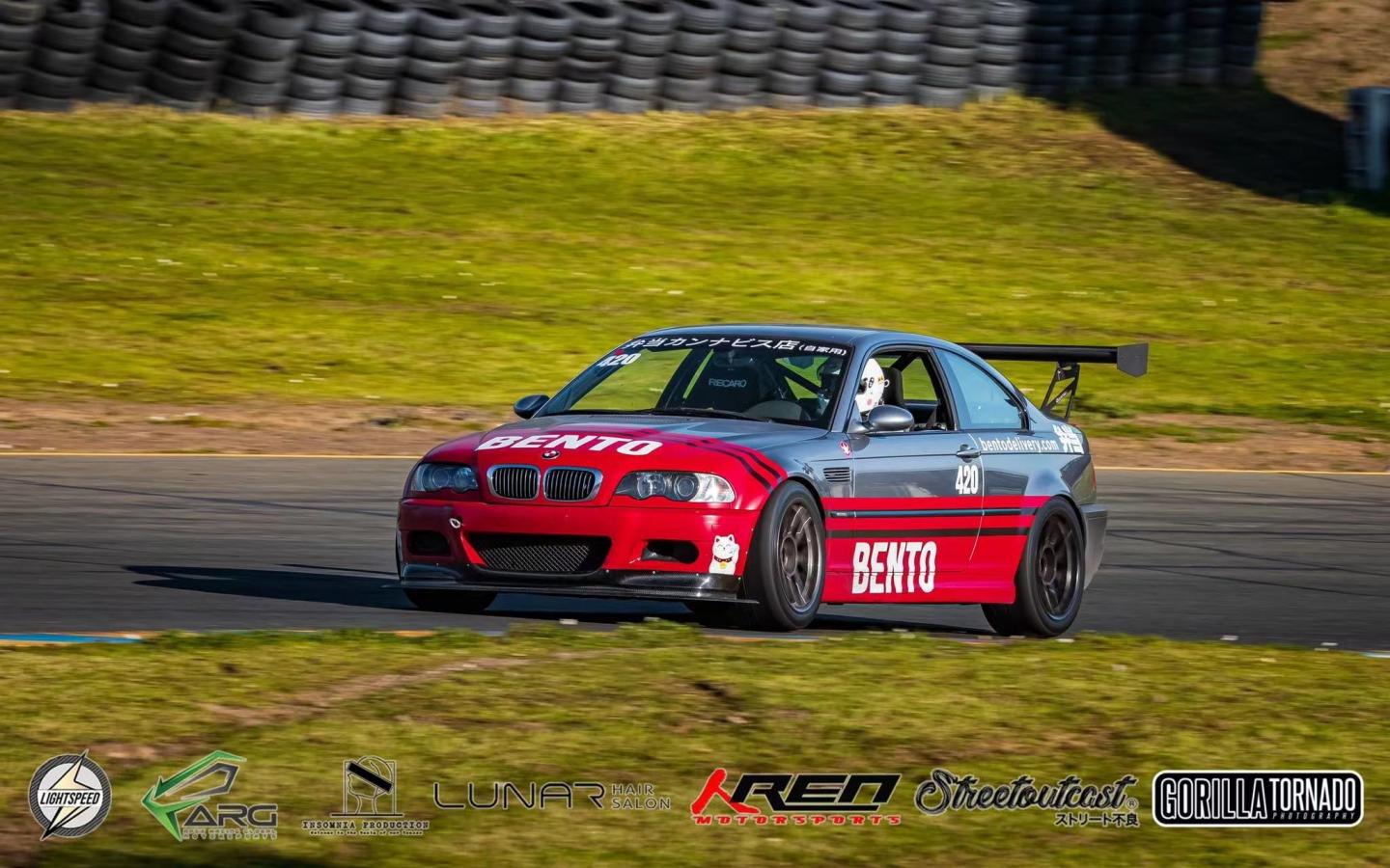

      Latest and greatest from Sonoma Raceway. First time there since installation of Bimmerworld V3 Aero. Was definitely a game changer for Turn 1&2. Current PR at a 1:51.52.
      Goal is to ditch the passenger and be in the 1:50s on the way to 1:49s next time.
      Any and all feedback is appreciated.
        Since I’ve put on aero, I sometimes get oversteer if I’m behind someone exiting a corner.
          #94
          Interesting. Haven't experienced that yet. I feel that post aero I'm fighting off a touch more understeer. Might be my driving or could be something to address in set up. Will be discussing with Tony at TC Design.

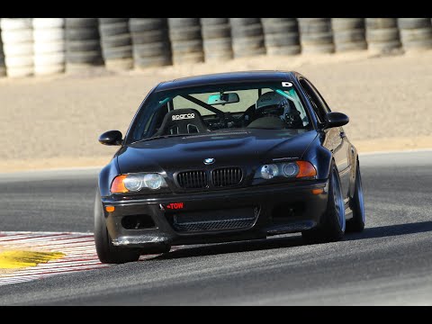

              First time to Laguna since aero installation and was pleased to be sub 1:40 on NT-01s with 20+ sessions on them. Excited to get back and keep chipping away.
              Fastest of the day was 1:39.73. Any and all pro-tips are sincerely appreciated.
                #97
                Is it possible to move the camera higher?
                I'd recommend playing with shock of swaybar setting to dial out the nervousness at the rear end. The oversteer is obvious, but the car look unsettled under braking as well
                Also, you should not be adding steering input after the apex of turn 9. Your too far left at the entrance of the corner which pinches your exit causing the additional yank on the wheel post apex. You should be on the gas before the apex and opening up the wheel just after it to track out.
