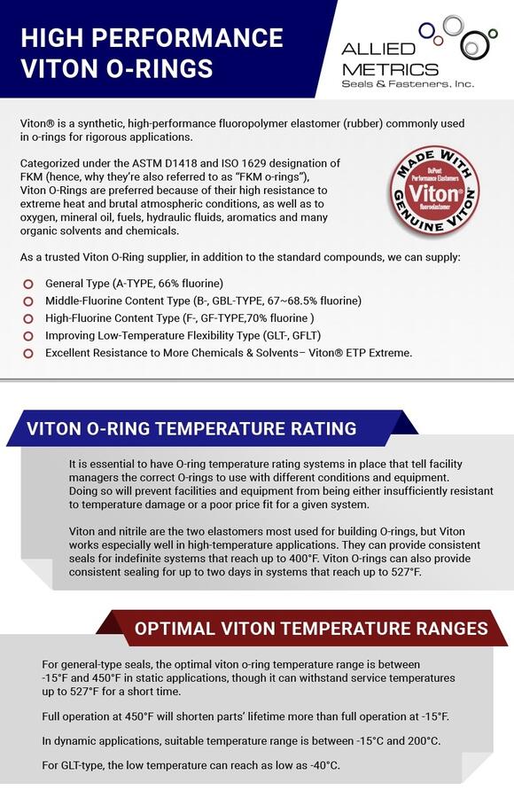

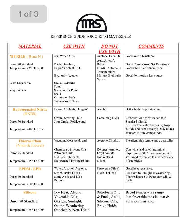

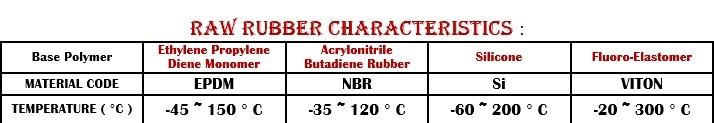

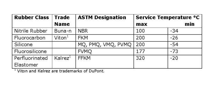

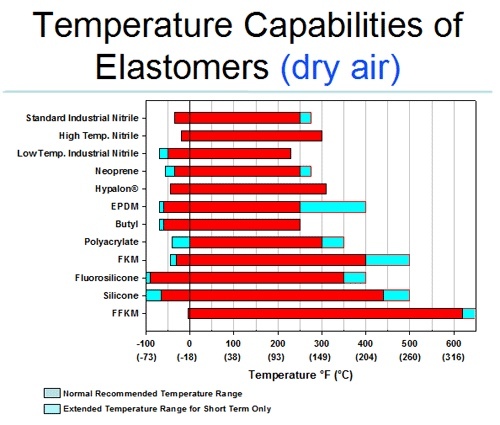

    Is Viton unsuitable for colder climates then? In the Great Lakes, it routinely gets into the negative degrees F in the winter. Not that I'd be driving my M3 in those conditions, but unheated garages can definitely dip below 5°F. Can the material rebound from repeatedly cycling down below its low temperature limit, or is it permanently compromised if it has spent time under its limit?
    Good question. Viton cold temperature range is approx -15 F compared to Buna which is approx -30 F. Depending on which article you read the temperature ratings vary and that article's rating is on the conservative side. One of the benefits of Viton vs Buna (other than being able to withstand higher temperatures) is it's resistant to compression set. How many times have you seen flat Buna O-rings that do not seal anymore? Since using the Viton and Hi-Temp Silicone O-rings I've taken my cooling system apart several times and reused them with NO issues and my Power Steering and SMG reservoirs no longer leak from the caps. I've sold approx 60 of these Hi-Temp O-ring kits and not a single issue. Some of the O-rings in the kit are slightly thicker than the OE ones which in turn should provide a better seal.
    Here is a few different charts showing the different temperature ratings between Viton and Buna. Safe to say Viton can withstand approx -15 degrees fahrenheit.
    Click image for larger version  Name:	High-Performance-Viton-O-Rings.jpg Views:	0 Size:	108.5 KB ID:	63912
