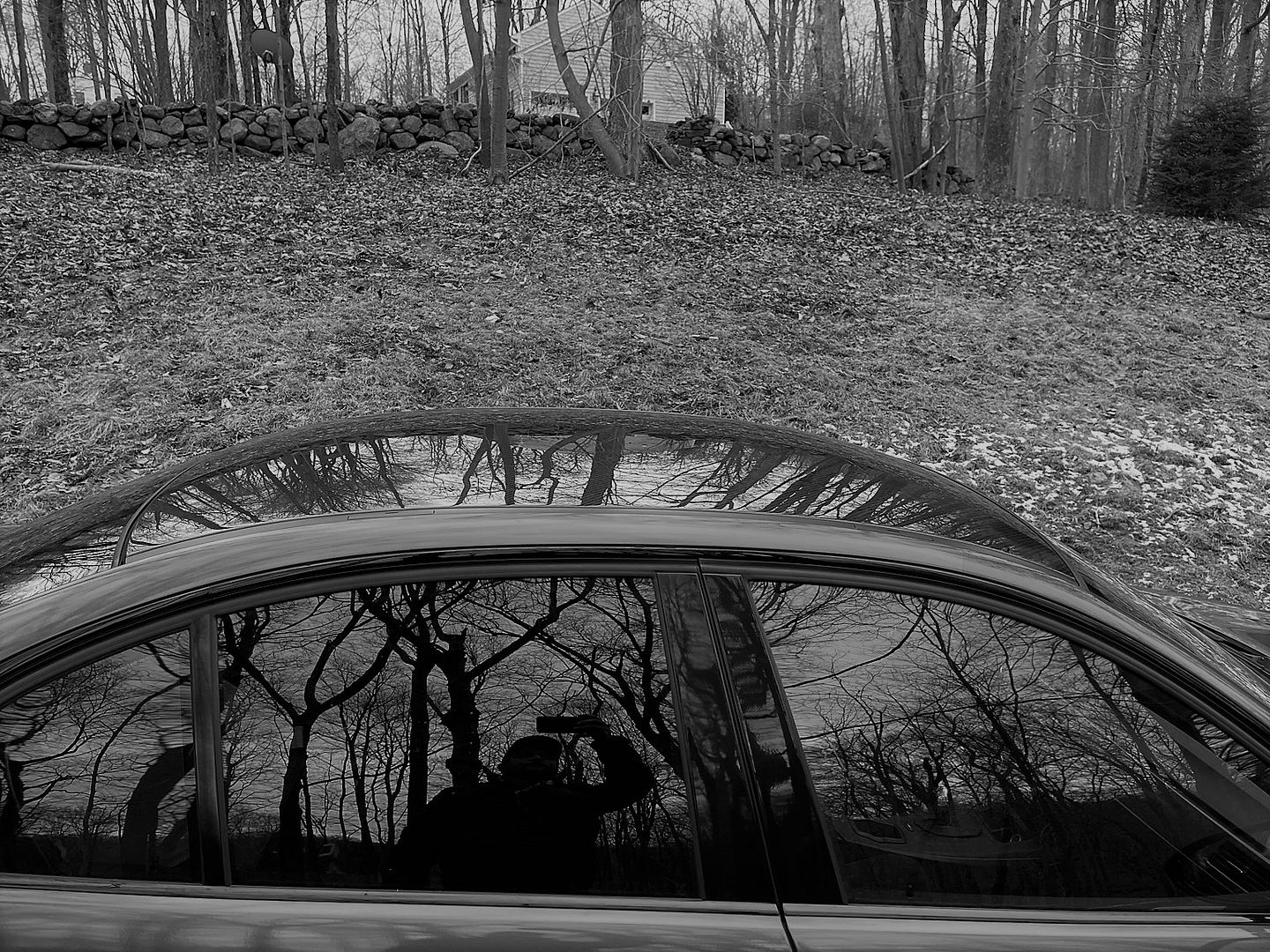

    Pics comparing to E92

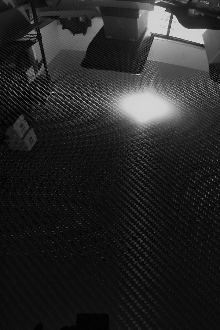

    Closeup of the weave

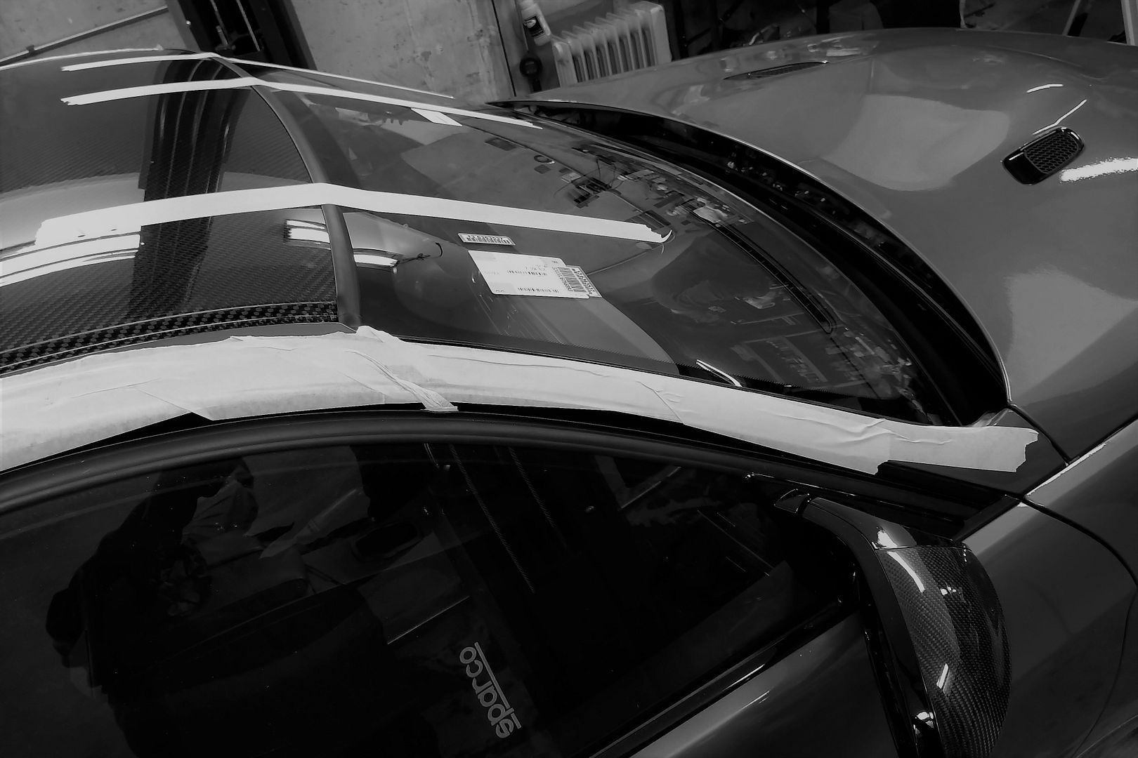

    Pics showing install

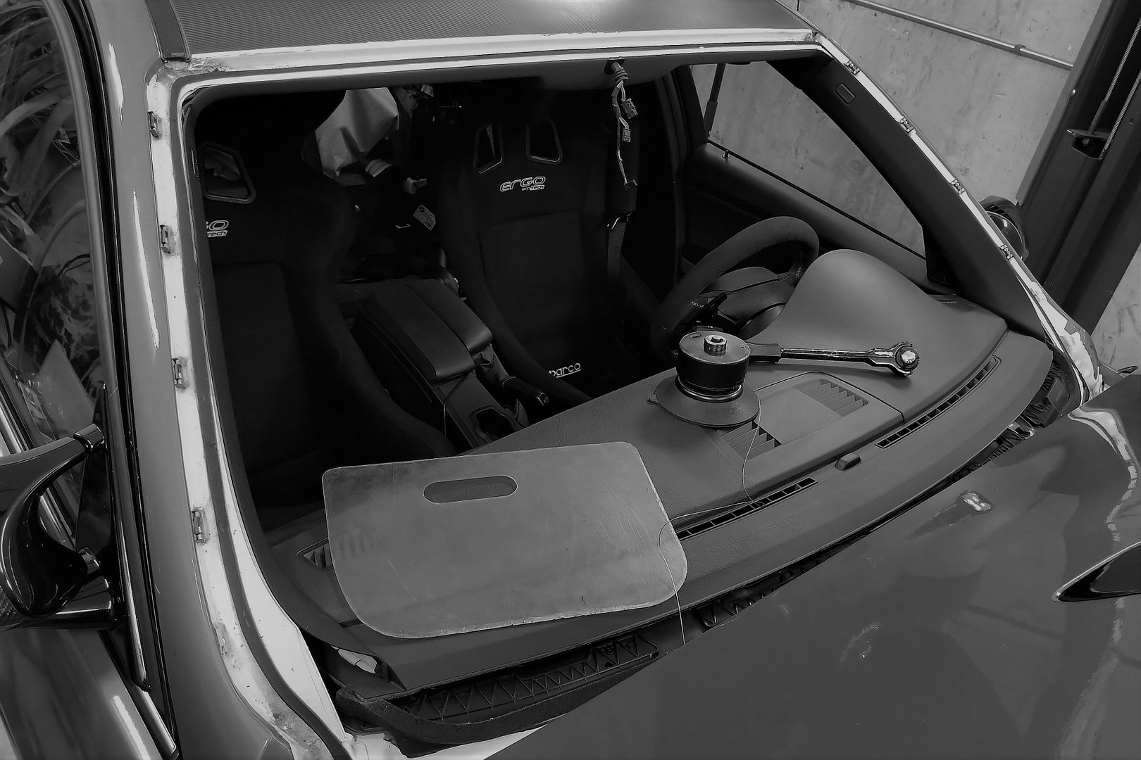

    To install you basically cut out the front and rear glass hoping not to break them. Then you cut out the roof, prepare the surfaces, glue the CF one in.
    If your car was a slicktop the reinforcements are in place, but if it was a sunroof car you need to weld in a replacement, or you can glue in a CF reinforcement piece Slonik has
    If the body is scratched then it may rust, so anything that gets scratched must be passivated before installing the roof or the glass

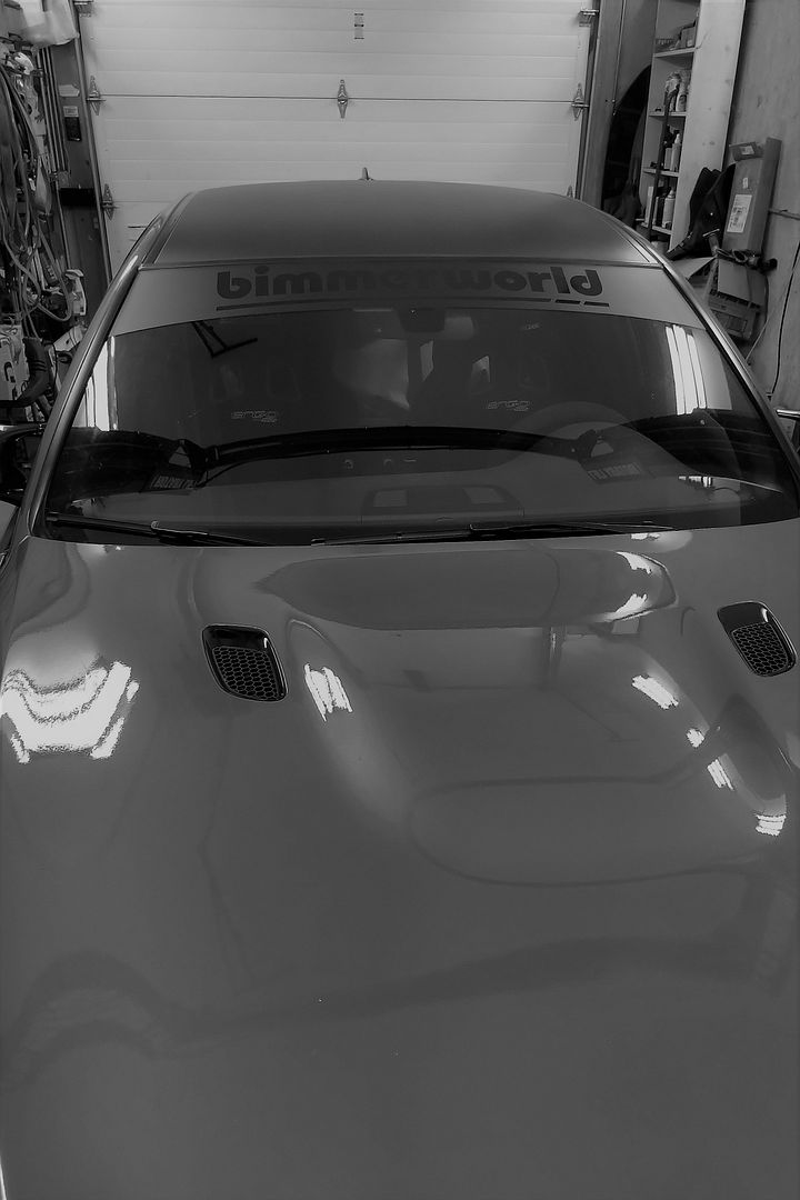

    In my ‘before’ pics you can see I have a vinyl wrap on the roof as well as a Bimmerworld banner. My front glass had a 16” crack in it but it didn’t break removing it. Of course this was replaced with new OEM BMW glass during the reinstall

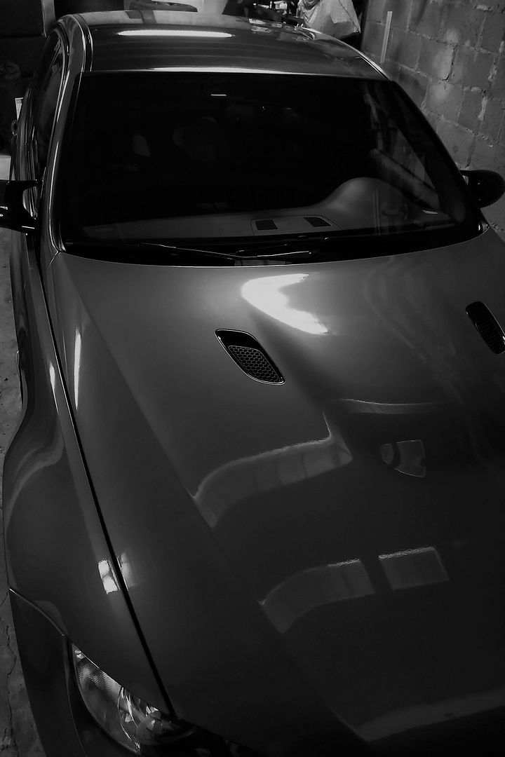

    Before:

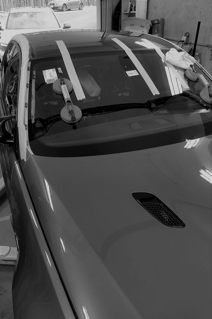

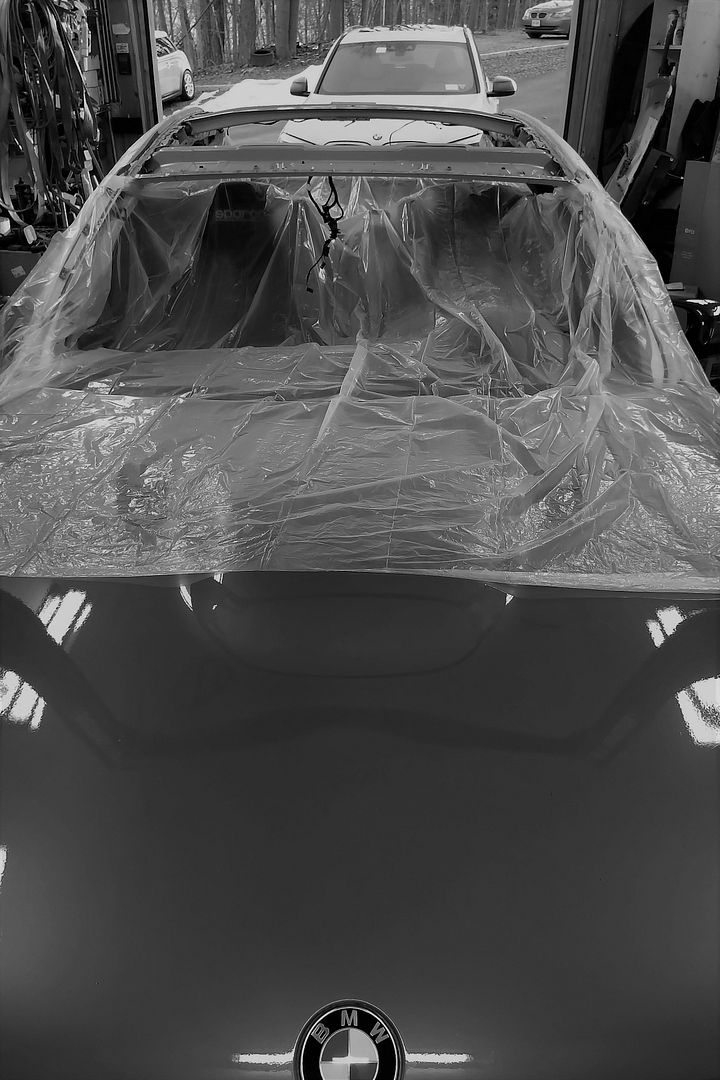

    Front glass out:

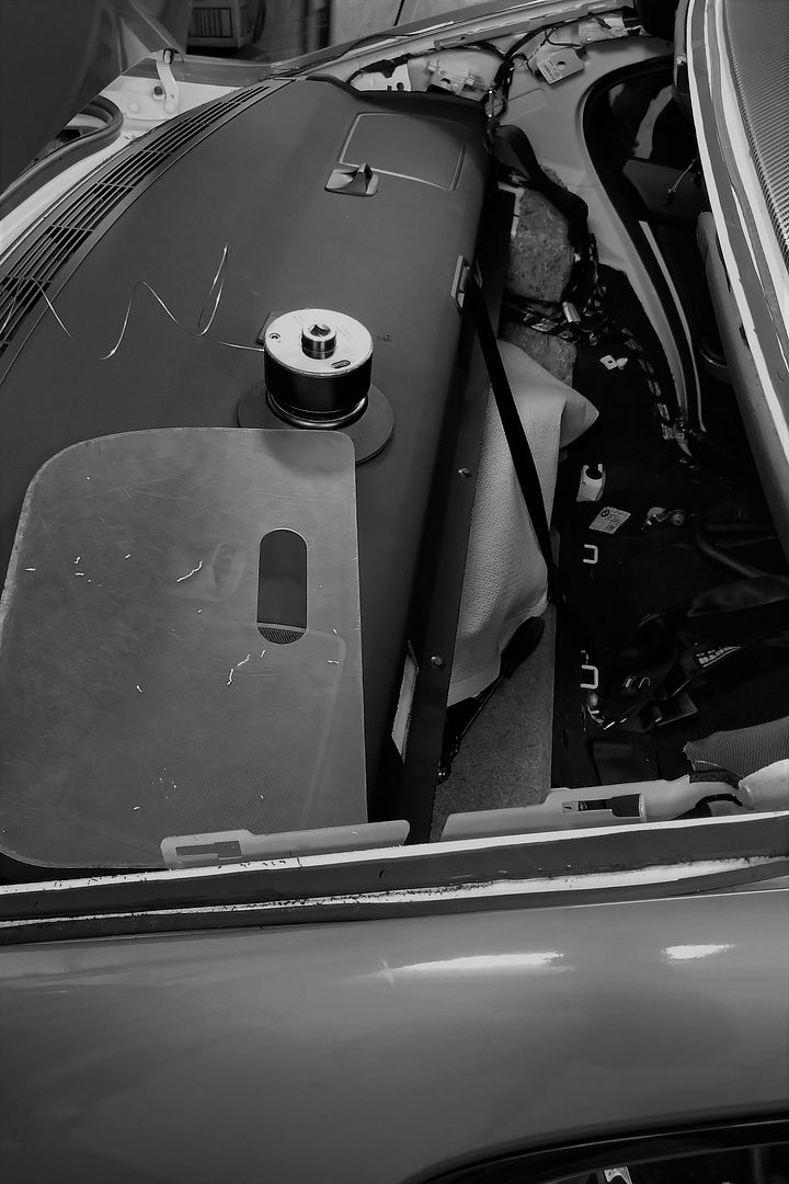

    Rear glass out:

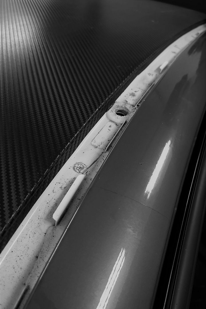

    Spot welds getting drilled out

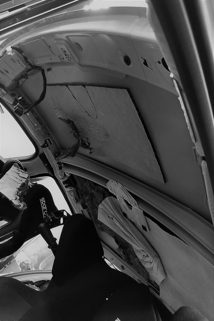

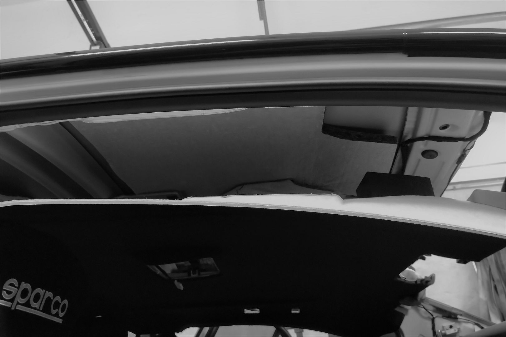

    Headliner removed
    Car has no glass! Weight reduction FTW!

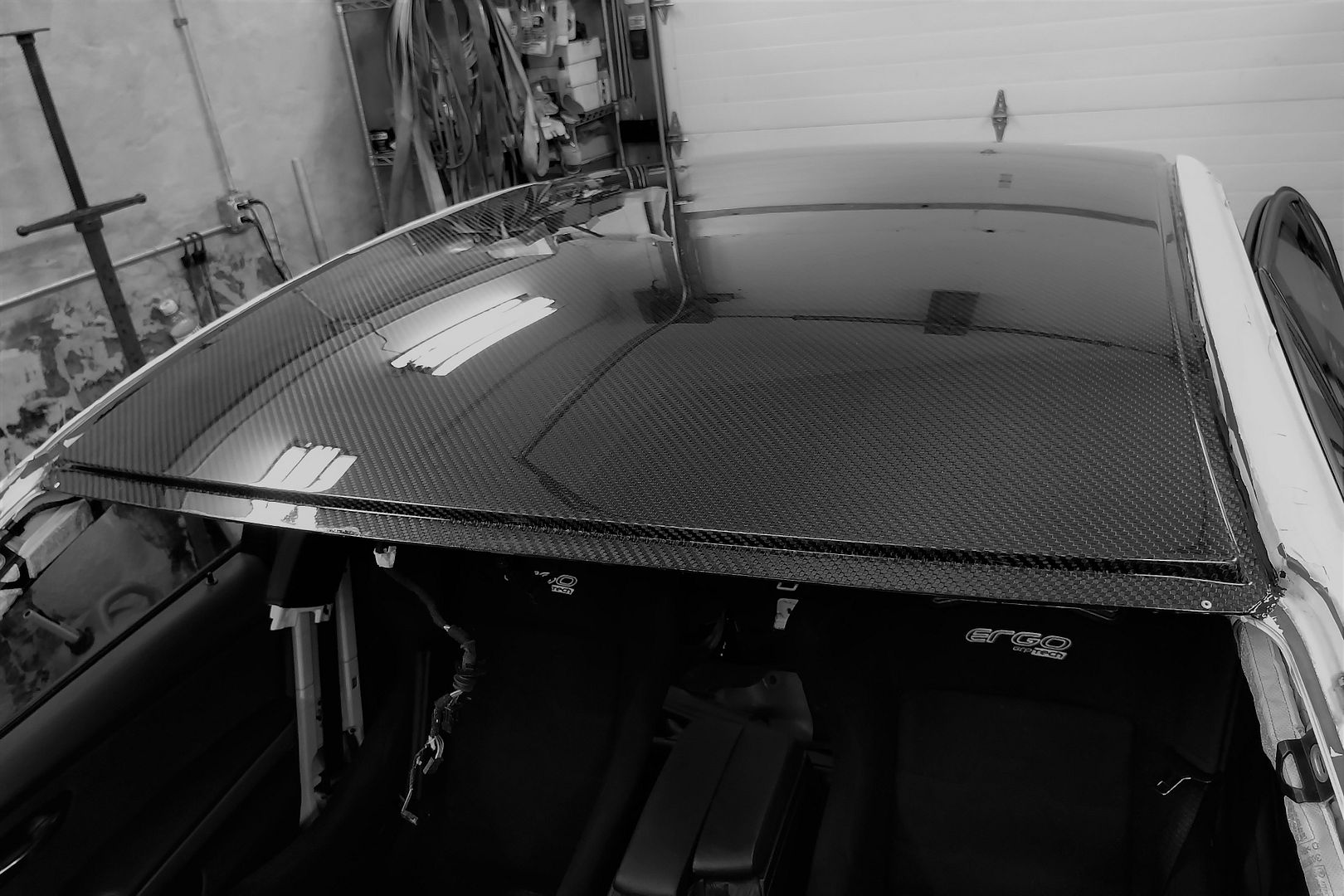

    Test fit the CF roof

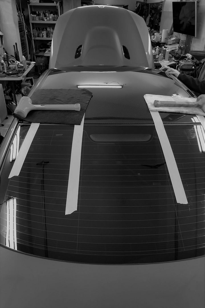

    After gluing the roof you do the front and rear glass
    You let the car sit for a couple days for the glue to dry and voila, CF roof on an E90!
