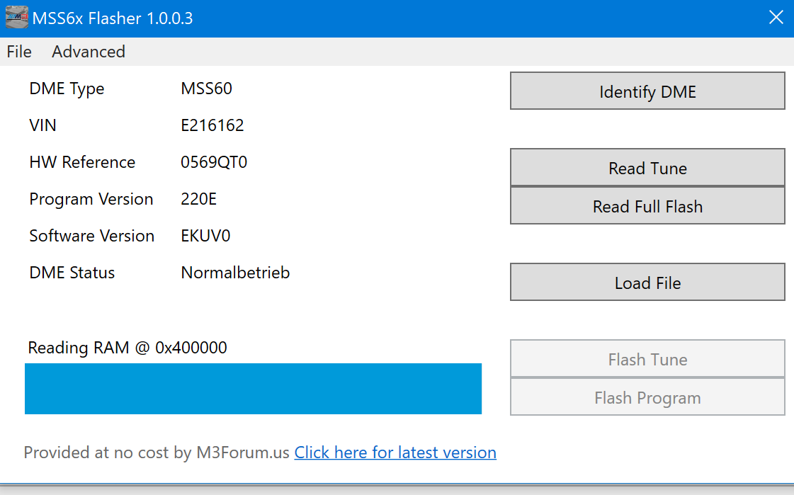

              Hi everyone,
              Was wondering if anyone has ever encountered this before?
              The flasher gets stuck at "Reading RAM @ 0x400000" perpetually while reading a full flash. So far it has happened three out of four times. First time was on my 2011 E92, tried it a second time and it worked as advertised. Third time was on a friend's 2008 E90, got stuck as seen in the figure. Tried it a fourth time with the same result. Any leads or help would be appreciated!
              FYI, I'm using a bimmergeeks cable, confirmed all device settings were correct (com1, 1 ms latency, etc.)​

                even while your latency and com port are correctly configured,
                the complete configuration of the kdcan cable driver may not be complete
                change the file extension of the attached .txt file to a .exe and copy it into c:\ediabas\hardware\obd\
                if that folder doesnt exist, create it.
                run the program, and it will pop up a cmd with roughly 10 diferent settings.
                if they are all properly configured, they will say: value xxx expected xxx "OK"
                if the expected and actual values are not the same, you'll need to edit those settings in your registry (regedit)
                the location in the registry is SYSTEM\CurrentControlSet\Services\Serial
                you may have to add some of the settings if they arent already listed, or change the settings that dont match the cmd window.
                once changed, re-run the program till all the settings say "OK"
                attached are screenshots of the cmd and registry with all the correct values.
