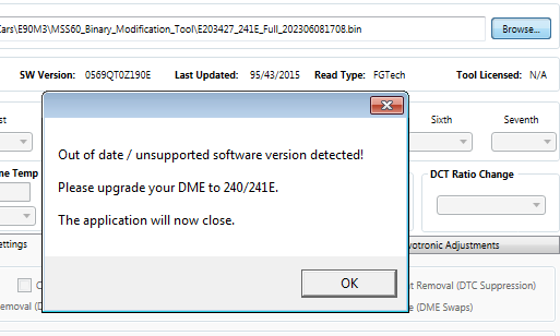

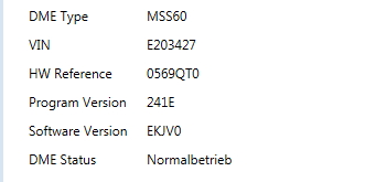

              I'm running into a weird issue where the full read by MSS6XFlasher is considered outdated/unsupported by the Binary Modification Tool. My DME is already on 241E. Please see the attached images. This full image was read as one of the steps detailed here: https://www.ecuworx.co.uk/how-to/tak...mss6x-flasher/ . There were no errors/issues while executing all the steps in that article. Any insight?

                You get this issue when the DME has been updated but the AIF hasnt. Easy fix is just to reflash with WinKFP again ensuring AIF updates are ticked in the options.

                  Thanks for the quick response. This is clearly a learning opportunity as I have not used WinKFP before. A tuner had updated my DME to 241E years ago. I will try to reflash soon.
