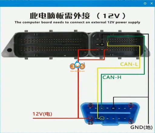

                          One last question: Is the picture below correct to create a bench set-up for an MSS65? I checked with wiring diagrams from TIS and I think this is fine.
                          Thanks a lot for reading all of this and maybe someone can even help me with some of my points.​
                            Seems fine to me.
