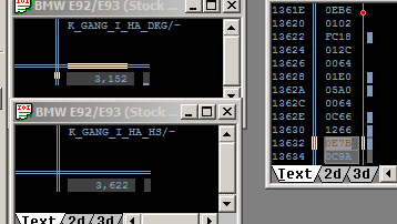

            2 new values identified :
            K_GANG_I_HA_HS - Final drive Manual - 0x13632
            K_GANG_I_HA_DKG - Final drive DCT - 0x13634
            x/1024
            Precision 3

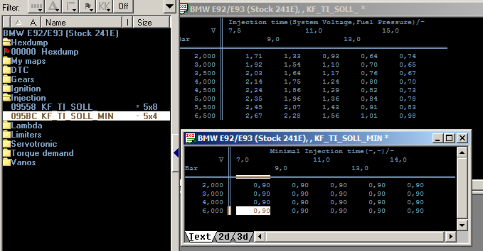

                    Hey guys, I think I've found KF_TI_SOLL_MIN ( minimum injection time ) and KF_TI_SOLL_UB_OFFS ( injector dead times )

                    Comments are welcome

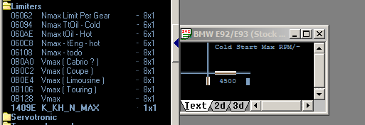

                      K_KH_N_MAX ( RPM threshold for cat preheat deactivation ) -> set this to a low value to deactivate cold start.

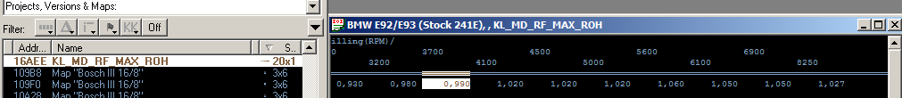

                        @16AEE
                        KL_MD_RF_MAX_ROH ( Max relative Filling / RPM )
                        20x1
                        X : RPM x 1 , precision 0
                        relative filling, x/10000 , precision 3

                              Is this the stock cold start max rpm value in the screenshot or lowered value to deactivate code start?
