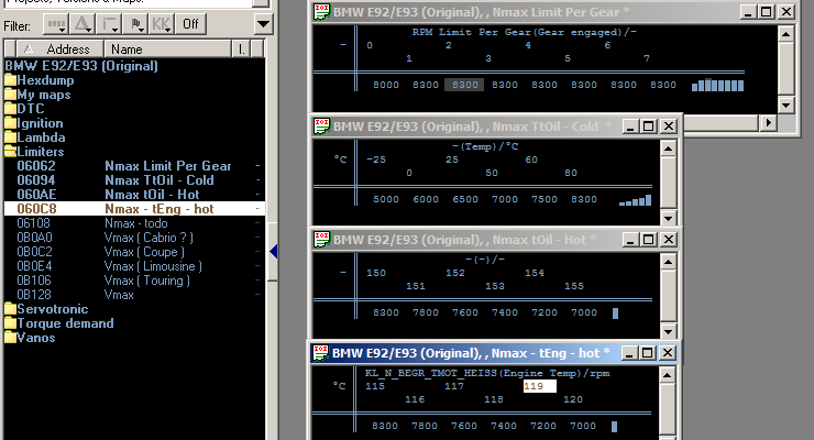

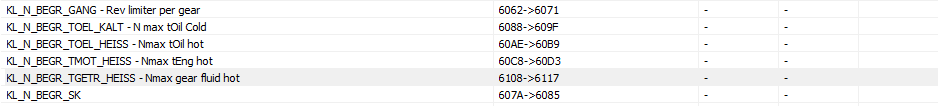

              Originally posted by dmlf View Post
              Here are some other rpm limiters I found :
              Click image for larger version Name:	limiters.PNG Views:	0 Size:	35.2 KB ID:	71142​
              Martyn I noticed that your bin modification tool only lists the "hot" oil rpm limiters, maybe you could add the cold one too !
              hi.
              i think i've found those rev limit parameters.
              ​​Click image for larger version
              my target is 8500rev, so i did put 8500 to these parameters but when i put 8500 to KL_N_BEGR_TMOT_HEISS engine stalls with warning light on.
              i'm assuming that there is KL_N_BEGR_TMOT_KALT or something?
              do you guys have any idea to solve this?
              ​thanks.

                #67
                Never had problems like you described.
                ​thanks.
                Yes, there is also a cold map for warming up. They should all be placed close to each other.
                Upload your file and I can have a look.
                  #68
                  hi.
                  i attached with mine.
                  since when i put 8500 to KL_N_BEGR_TMOT_HEISS causes crash. so this binary leaves KL_N_BEGR_TMOT_HEISS 8300.
                  also i'm editing binary with this xdf file.
                  GitHub is where people build software. More than 225 million people use GitHub to discover, fork, and contribute to over 800 million projects.
                  thanks.
                    #69
                    upload your tune (128kb) file as well. Once you have done RSA bypass you don't need to write the full file again.
                      #70
                      thank you for your advice.
                        #71
                        Try this one
                          #72
                          Try this one
                          hi
                          it worked like a charm!
                          thank you so much for your help!
