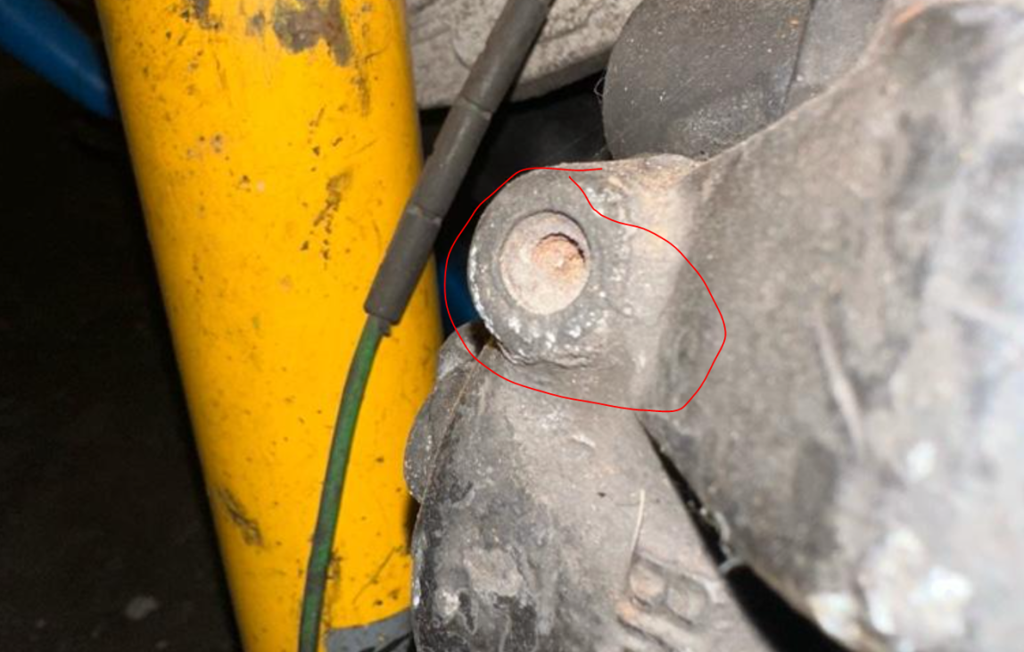

          So how screwed am I?
            #35
            Seems shitty. You have a welder?
            because welding a nut onto that is gonna be the best way to get it out.
              Agreed.
              Good clean up, a couple of zaps to build up a little nub and un freeze the rust bond and it'll pop out.

                  I’m telling you, take to a machine shop that uses a process called EDM. Look up shops near you that do this process. Have had to get this done in past on a expensive/rare caliper. Look it up, calipers with hard metal housings are good candidates for this.

                      There is video on YT on this process
                      they used a reverse drill bit to extract the broken bleeder
                      i will see if i can find it

                        soak with ATF then just tapping on the Impact Drive with a flat bit as I posted previously. Make sure to set the ID to turn CCW.

                          Sorry they are called left hand drill bits set carbide tips
                          Watch the video below
