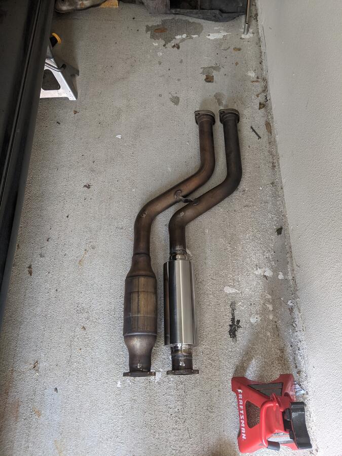

          I would get a euro section one, and weld in two ar20’s to it.
            How would that work? Cut off the cats? Seems it would be way cheaper to start with US sec 1.

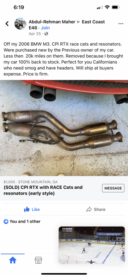

              I think he would just need to cut off the straight pipe section and weld in two ar20’s? I was fortunate to grab a early model cpi rtx section one with race cats for sale a few weeks ago and it’s the perfect setup for me. It’s gotten rid of 95% of the noxious fumes and 100% of the rasp
