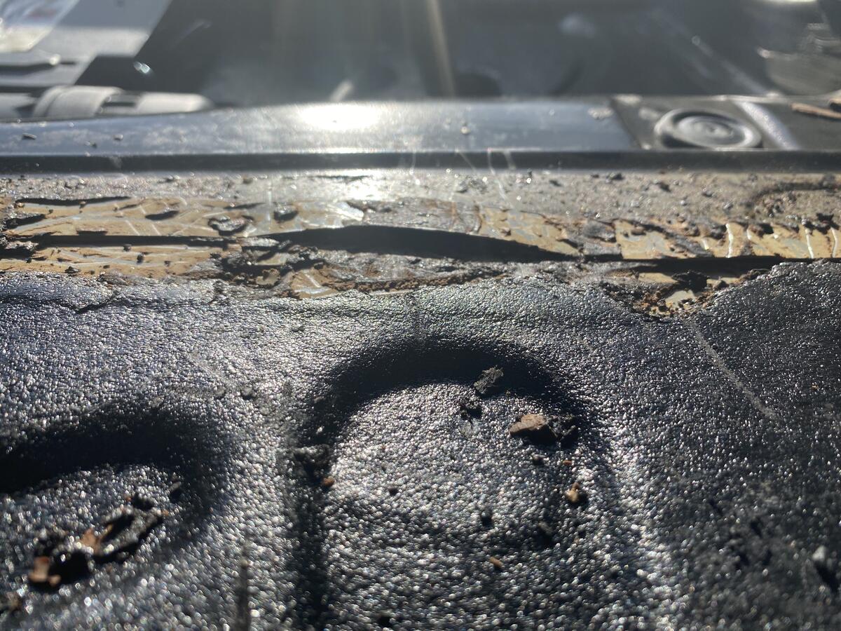

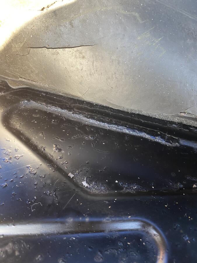

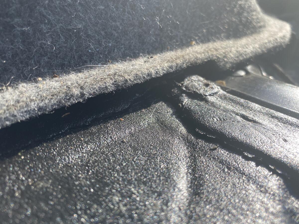

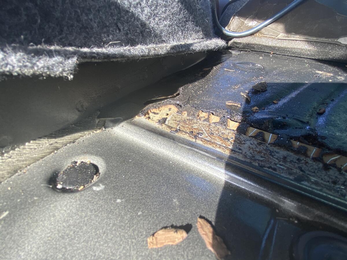

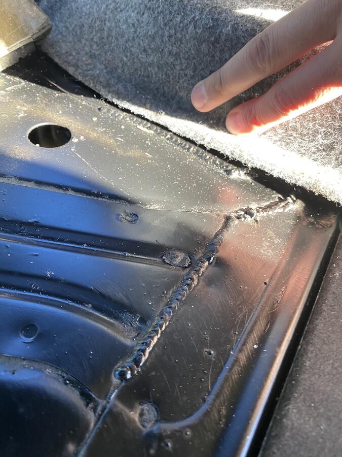

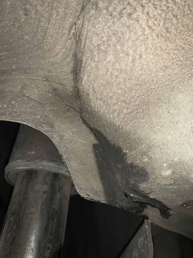

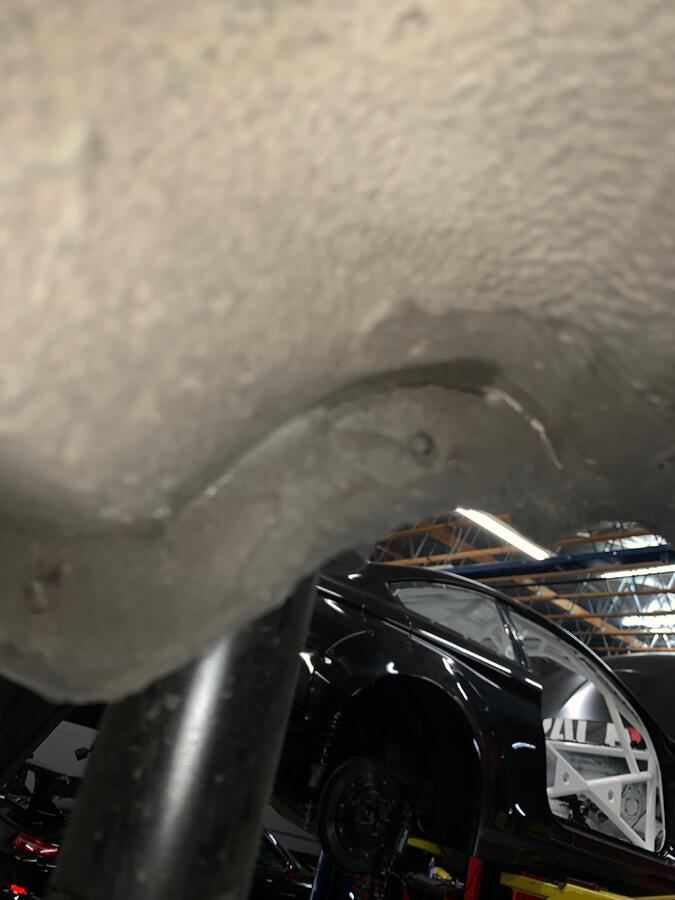

    Anyway, my car has TMS reinforcement plates installed and previously had stock subframe/differential bushings. I've always kept an eye on the rear despite the fact for exactly this reason. My car is an '04 so it has the updated spot welds as well. And she is also tracked and driven (I think) like a proper M car. Here are the cracks which I initially found.

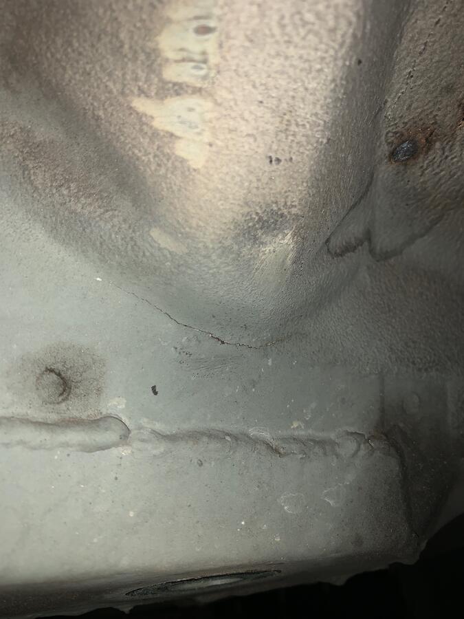

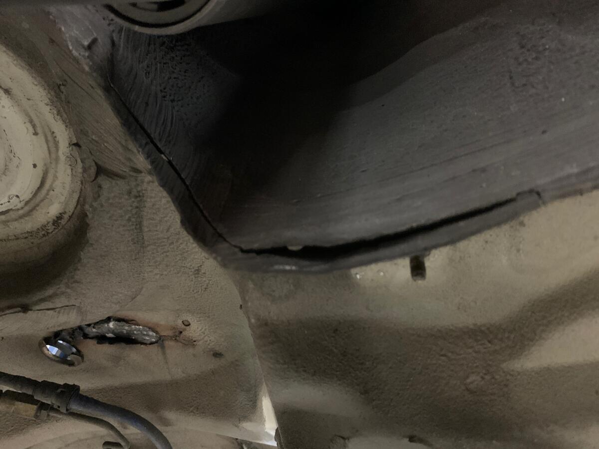

    Once I took it to the shop and they took off the sound deadening and dropped the subframe they found additional cracks. The RACP was tearing itself apart!
    Click image for larger version  Name:	IMG_1421.JPG Views:	45 Size:	45.1 KB ID:	10547 Click image for larger version  Name:	IMG_1422.JPG Views:	45 Size:	85.7 KB ID:	10548 Click image for larger version  Name:	IMG_1420.JPG Views:	46 Size:	65.5 KB ID:	10549 Click image for larger version  Name:	IMG_1419.JPG Views:	45 Size:	102.4 KB ID:	10550

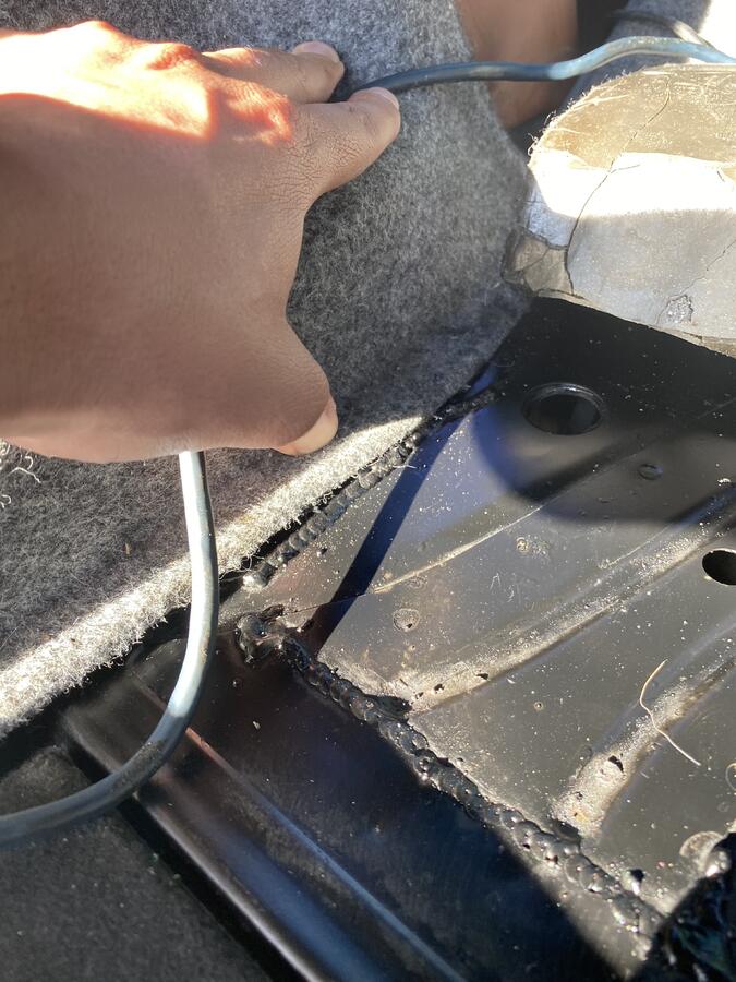

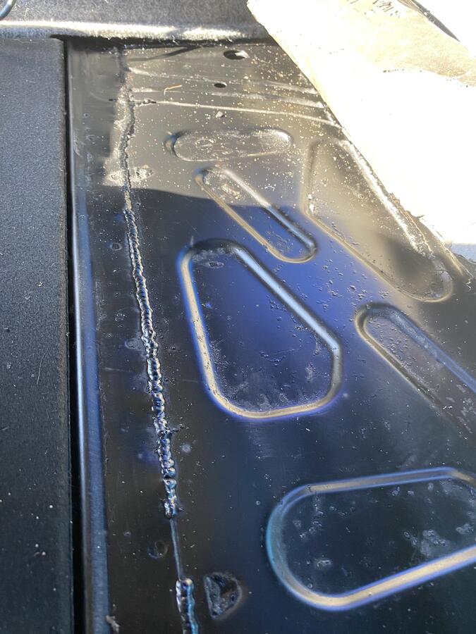

    As you can see, once the plates are installed the mounting points are no longer the weak spot and the stress continues to flex the RACP. I knew it would have additional cracks but I didn't think it was going to be this bad. The cracks were stitched up and I went with the Turner Delrin/Aluminum subframe bushings and AKG poly diff bushings. All in all I'm very impressed how well the car feels now. Solid, direct, and with a teeny weeny little diff whine - which I kinda like haha. The whine has actually attenuated since I first drove it to where I barely hear it even with windows up and stereo off.
    Click image for larger version  Name:	IMG_2895.jpg Views:	46 Size:	79.2 KB ID:	10551 Click image for larger version  Name:	IMG_7627.jpg Views:	45 Size:	90.7 KB ID:	10552 Click image for larger version  Name:	IMG_8966.jpg Views:	45 Size:	99.5 KB ID:	10553 Click image for larger version  Name:	IMG_2076.jpg Views:	46 Size:	96.3 KB ID:	10554
    Now that she's back on the road I'm thinking of preventative measures to prevent this from happening again. I have an xbrace which I bought and haven't had the time to install. But from my understanding, it only addresses the rear two mounting points. So if I install it, I have to somehow address the front two points. I'm sure the RACP will hold on until I figure out a solution, especially with the solid subframe bushings. I think that made the biggest difference in terms of reducing flex in the rear.

                        If you have damage that can be seen from inside the trunk then there will be a lot more damage underneath. You need to remove the subframe to find all cracks, since most of the time there will be some around the subframe mounting points and these will be covered up by the bushings.
