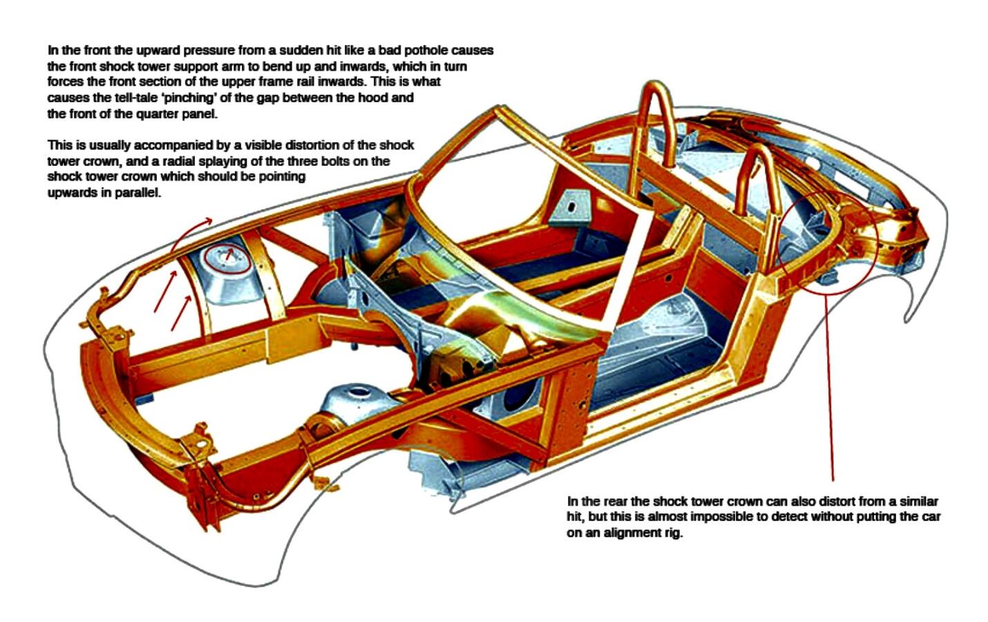

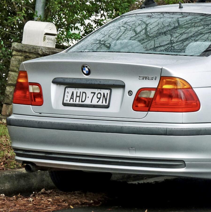

      ...a 318i, which everyone can see is far and away from being a sporting car chassis. That 318i indicates it is just a chassis for a common passenger car, albeit one that is priced in the junior luxury car class of vehicles. Hell, even when BMW cooks-up a premium priced ($100,000 dollars+) and dedicated sports car in the form of the Z8, they still choke and can’t get it right; the Z8 suffers from the front shock tower support failing, and it’s symptom is a tweaked shut line between the hood and fenders.

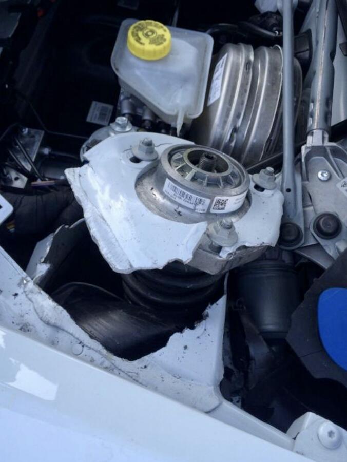

      Then again, even a Porsche, a true sports car maker isn’t immune from screwing the pooch. At least we don’t experience this... 🤔 🤬
