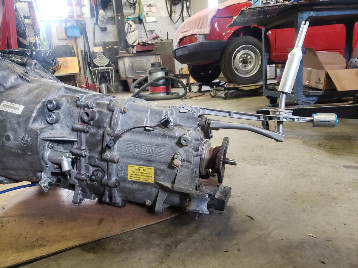

                        Im wondering about the linkage, maybe I placed the shifter rod backwards lol

                            Beginning to get paranoid i might have installed the linkage upside-down.. bow upward or down?
                              This is correct. The "bow" is to provide clearance for the giubo (flex disc)
