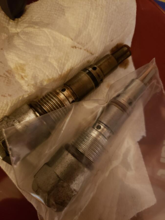

          The Vanos Pressure Regulator came in from Dr.Vanos, on the right. Looks more like a traditional oring on the end, whereas the one from my vanos looks more like a black band. Should I have a preference for one or the other?
            That black band used to be an o-ring when new. It's only flattened because it's old and heat cycled. Definite preference for the new part.
              Wow, thanks. Its perfectly flattened without any bulges like might be present on a deformed part. I'll be sure to use the new one.
