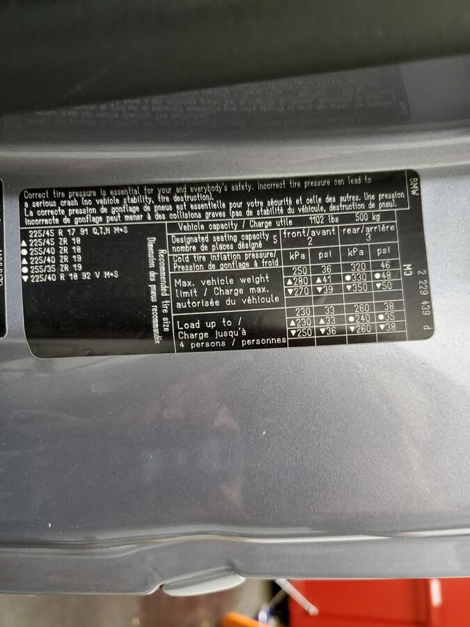

            I believe the door card recommends 41psi(not42) front and 48psi for speeds over 100mph. That's what I do.
              I believe the door card recommends 42psi front and 48psi for speeds over 100mph. That's what I do.
              No sir. The card states 41 and 48 psi at max vehicle weight, nothing about road speed. At driver only weight, that's gotta be like driving on a washboard.
                Pic of that door card?

                    At 46-50 psi cold - the car should feel like Fred Flintstone's car.
                      I'll take a picture eventually. The warning is a yellow one above the regular pressure card. It's very common to request higher pressures for high speed. If a Porsche isn't at max load and you exceed a certain speed limit, the dash will scream at you to slow down and put your tires at max load. It's probably to decrease rolling friction and compensate for downforce. A larger contact patch means more heat. The car drives great around town.
                        I made the mistake of the following the door card on my ‘05 until Obioban pointed out the change made in the later years of the model run. Addressed here: https://nam3forum.com/forums/forum/m...5-19-275-30-19
