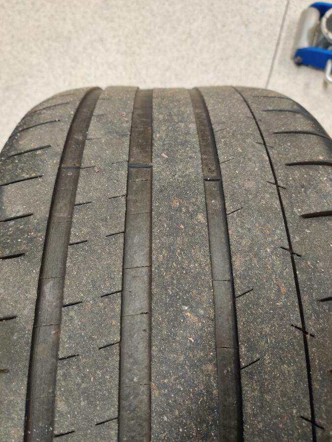

              The reason I asked is with 275 rears (Michelin Pilot Super Sport) running at 31-32 psi cold, I got significant wear on the center of the tread. Or, a clear sign of over-inflation. I recently put ~5k miles on the tires without really scrutinizing the tread pattern and the wear is surprisingly significant. At 31-32 psi (already 3-4psi under the door placard), the only thing I can think of is that the load rating is so different from stock that the tires just do not need that much air.
              Hence, I was hoping others might corroborate my theory. Which is: When going a good bit wider than stock, given all other things equal, running lower pressure than what the door placard calls for makes sense. That's why I was highlighting the load index of the tire. Going up even further from 275s to the 285s I just put on, they need even less air to hold the same weight. Which is typically just me + the car.

                For reference, here is the offending rear tire. It has about 20k miles on it when I took it off the car.
                Click image for larger version  Name:	IMG_20210506_201403.jpg Views:	0 Size:	105.9 KB ID:	108051
                  I run 36 front 38 rear for street.
                    The proof is in the pudding. That looks like an overinflated tire if I've ever seen one, and I've seen many. How often are you above 100mph versus regular driving?
