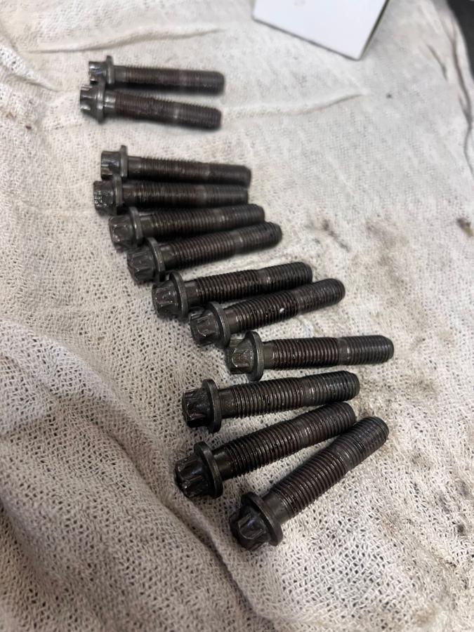

                    Not sure what to make of this, but in the picture you posted with the tech torquing the rod bolts, those appear to be ARP rod bolts.
                      Not sure what to make of this, but in the picture you posted with the tech torqueing the rod bolts, those appear to be ARP rod bolts.
                      I think that picture is reassembly, I told them I was okay with ARP bolts if they torque them to stretch specs. I'm going by today to pick up the old bolts and will post pictures.
                        Below is a picture of the bolts that were removed. OEM.
