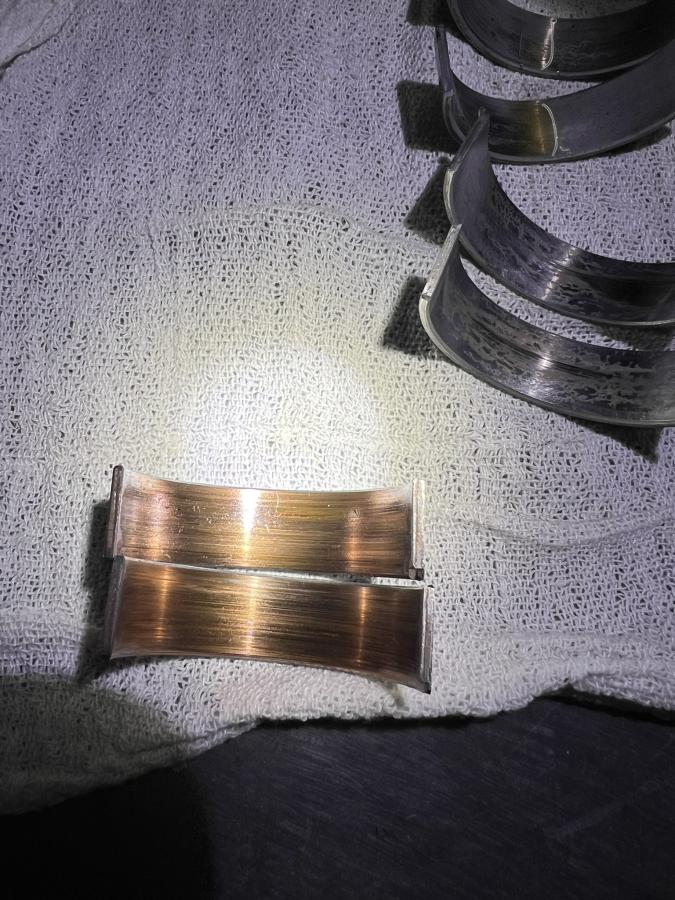

    The appearance of the removed bearings is not bad but out of tolerance,I will never install an ACL again
      by tolerance, are you referring to clearance?

        yes I mean the clearance... I have read other threads on acl... good for many and some with problems

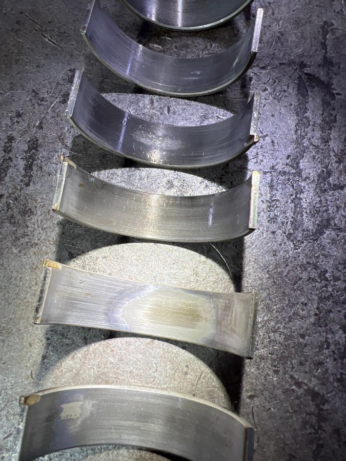

                I initially changed the bearings because I knew they were original, and was not sure of their condition (52k miles). It was part of the baselining of the car. The original bearings that came out were actually in nice shape, with predictable but relatively minor wear.
                BimmerWorld did not say there was an active recall in place for BE, they just said they were in early stages of investigating a higher than average number of failures from a specific batch. That said, there's no hiding that my new bearings were TRASHED in just a few hundred miles.
                Another potential factor is that the shop that changed my bearings told me that "there is no wear in process" - so after a couple hundred miles of light load driving, I had a HPDE scheduled and I used the car in the HPDE. The WPS bearings that are in it now will get babied for the first 1k miles, all below 5k rpm.
                With that in mind, I suspect the problem in my case was one of these two:
                1) Issue with the bearings themselves, based on BimmerWorld's comment that the specific batch of BE bearings was showing higher than normal warranty returns for spun bearings very shortly after installation
                2) Issue with the installation / torquing sequence of the bolts. The shop that installed them normally uses ARP bolts, not OEM, and may not have followed the proper torquing sequence for OEM bolts. This could be exacerbated by the HPDE.
                I'm not sure which.

                  In my case I reversed the faulty bearings with others that were ok and then the opposite... the problem was reversed... now I have fitted everything original and zero problems... let's hope

                          Click image for larger version Name:	IMG_5821.jpg Views:	8 Size:	124.8 KB ID:	283073
                          New WPS bearings going in, and sending the BE's back for investigation.
                          Funny how this looks exactly like my BE bearings. Such a coincidence. Where did you send them for investigation? BE?
                            Here is mine for comparison.

                              The shop that replaced them is working with Bimmerworld to determine next steps. The shop's main concern is getting reimbursed, since they warrantied my repair. Bimmerworld will then go back to BE I assume. I have a good relationship with the shop, so i'll message them in a week or so to see what they did.

                                Just trying to catch up on this, but my initial thoughts is siding with Mr R.Collins right now, we've seen many times before of sketchy claims with no data or root cause analysis done, just jumping to conclusions and blaming a part.
                                Those that can and have provided details often found the root cause to not be the actual bearings themselves rather install error or mistake. Unfortunately this case involves second hand info and only what the shop has shared. Without seeing front and back of all bearings, pictures of the end caps and rod bolts all laid out neatly, it's really only a guessing game. Also since this is an S54 we would have needed to see the state of the oil pump.
                                There are too many things not shared, that could be covered up or omitted to save the shops reputation, obviously I'm not here to assign blame, just state the different possibilities.
                                S54 rod bearing replacement procedure has two added complications that S65 don't have.
                                1. Oil pump needs to be removed and installed correctly
                                2. mid-cycle rod bolt change
                                Getting either of those wrong would need to failure.
                                Then there is the added complication depending on rod bolt chosen, re-using the OEM early rod bolts. OP doesn't mentioned if his 2005 engine had the later style bolts (engine not replaced) and instead new OEM bolts were used. If new OEM bolts were use, I do see him mentioned that the shop thinks they may have used ARP torque spec, which probably isn't repeated 3 times to stretch the bolt like what OEM calls for and uses an angle torque spec which is more complicated and takes more time. Perhaps if the OEM bolts weren't stretched, after a period of time, they loosen, or simply was no longer at the correct spec. (Unless they tracked how much torque it took to remove the oem bolt after, it's hard to know how they can claim it was torqued correctly when checked).
                                Other potential issues could be oil pump or oil pickup related, which could lead to oil starvation and would cause worn bearings like the condition those BE bearings appear to be in.
                                Anyway my take away would be that a failure with only this info would be inconclusive and could be manipulated by omission of key facts.
                                I'm not concerned about BE Bearings having any issue at the moment. I am confident the ones I have installed will not be prone to failure. Until we have more facts, this changes nothing imo.
