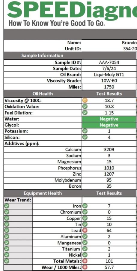

            Will, for what it's worth, my BE's looked exactly like Andratch bearings. I had less than 2k miles on them. My UOA from 300 miles before they spun showed 15ppm copper, and 64ppm of lead. That was the first oil change after bearings were done, so we were going to go another 1700 and do another UOA, but I never made it.
Name:	Screenshot 2024-12-16 at 7.35.23 PM.jpg

                                Update, just got Blackstone Analysis back. Iron is 22, Copper is 42, and Lead is 83. This is 1,300 miles after getting my rod bearings done with BE bearings in December 2024.
Name:	Oil Analysis.png
