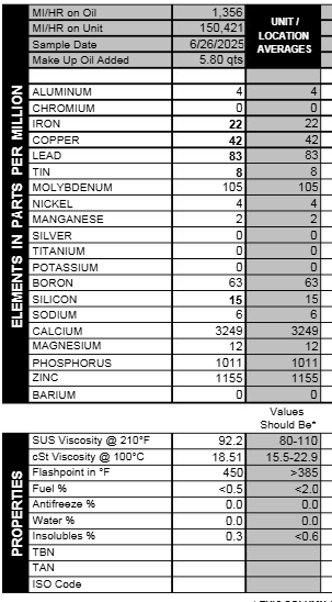

    Update, just got Blackstone Analysis back. Iron is 22, Copper is 42, and Lead is 83. This is 1,300 miles after getting my rod bearings done with BE bearings in December 2024.
    Click image for larger version  Name:	Oil Analysis.png Views:	23 Size:	60.1 KB ID:	313124
    I hate to say it but it is time to get back in there, something is wrong.

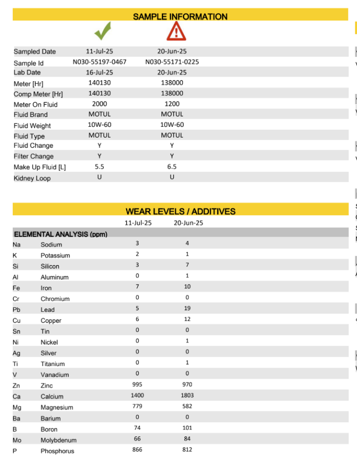

    Example:
    I KNOW for sure (I have the evidence) I had a spun bearing on cylinder #5 (caught it after I had already replaced my bearings and put it all back together. Stupid me...) and my car is still doing fine, no particles in my Oil Filter and sacrificial metals are trending down in my Oil Analysis.
    June 20th - 1000 Miles (1600KM) after swapping in new OEM bearings Oil Analysis showed 10 Iron, 19 Lead, and 12 Copper.
    July 11 - 1200 Miles (2000KM I have been driving ALOT) Oil Report is is showing 7 Iron, 5 Lead, and 6 Copper.
      Very suspicious. I'd probably pull the pan to inspect, sadly.
        Just wanted to update this with my issues. I finally got around to getting the oil pan pulled and inspecting the rod bearings and they are completely damaged with damage to the crank as well. The shop said they can try to clean up the crank and put new bearings in but it is a risk that the tolerance will be off. This is my BE Bearings with only 1300 miles on them, completely damaged. The shop said it's some of the worst rod bearing damage they've seen.

              In your case, the bad new bearings shed their soft layers so fast, and after only 1000 miles or so it was down to the copper layer, and the bearing clearance changed from 0.0015" when new to 0.006", for example. With zero oil pressure at start up the wide clearing of that single bearing caused the rattle until a decent oil pressure built up.
                How many miles on these bad new bearings? You have 4 bearings down to copper while Andratch caught it early with only one bearing down to copper. Yours clearance much be wider than his bad clearance, so there was so low oil pressure in those bearings, leading to damaged crank too.
