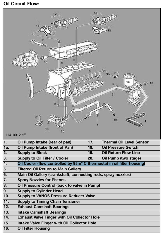

                From the E46 Complete Vehicle doc: "Oil Cooler (flow controlled by 95ºC thermostat in oil filter housing)"
                I presume this valve has nothing to do with temperature control and is just a check valve to ensure oil is available at startup?
