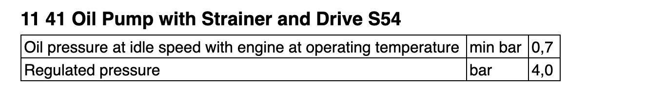

                          Anyone try doing an oil pressure test? Not sure what spec to look for at first start though

                            .7bar at idle
                              #59
                              .7bar at idle
                              That's at "operating temp" though, if it makes a difference.
Name:	Screen Shot 2024-08-16 at 9.41.25 PM.png
                                Oil temperature definitely will alter pressure. When cold it will be higher.
