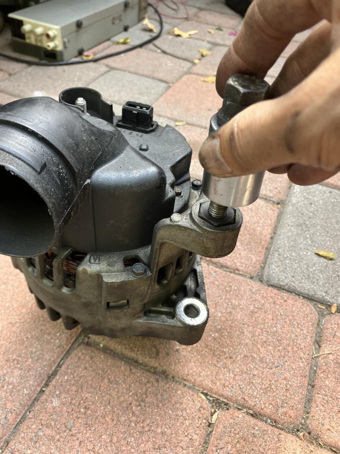

                    Alt is mounted by 2 long bolts: the top one serves as a pivot and doesn't lock the alt down (also holds the idler) and the bottom one locked the alt down by pulling the special sliding nut forward to clamp around the OFH flange.
                    I use a bolt and 22mm socket as spacer to pull the sliding nut rearward to "open the clamp" for remove/install. So I'm not surprised that the factory didn't set the nut at max "opened clamp" position.
                    To make it easy to remove the alt off the car, we should pull the said nut rearward about one turn of threads and this save our backache from working hard trying to pull it out.
                    The pic is a unit from non-M E46 but the feature is the same for M3 alt.
                      #70
                      Amazing info. Live and learn! I had no idea. This certainly would've gave me that half mm or so I needed to slide it on easier.
                        I did this as well. Didn't notice it at first and thought i'd have to grind the new housing, but then noticed i could gently persuade the 'nut' to proper clearance with a hammer.

                          with the alt ear supported on something it's safe to tap the nut rearward with a hammer. But I wouldn't use a hammer on the long bolt with the alt mounted on the car as this could break the alt ear, then it's a bigger headache.
