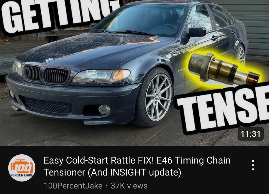

I just saw this title, and thought i would share

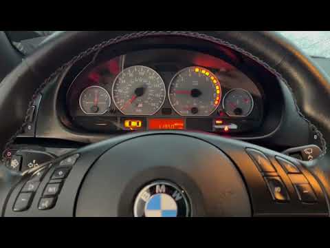

Cold start rattle 2-3 seconds then gone.
Originally posted by BL92 View PostI just saw this title, and thought i would share

I did replace my timing chain tensioner with a new one back over the winter because I didn't yet understand that the S54 is just a noisy engine in general, and so I was trying to eliminate a 'normal' noise by swapping what I now believe was a good, working tensioner with another new one. The shop called me on Friday to say that they took out the one I bought from FCP and replaced it again, and didn't hear the sound after 24 hours of sitting.....so, fingers crossed all this fuss was a faulty replacement part. I'm not overly confident, but I can't really see what else it could be.

I got my car back.......no dice on the second tensioner replacement. Noise persists.
The shop noticed that there is a little rattle between 2-3k rpm, almost exactly like THIS and suggested maybe it's Vanos related. My car already has the Beisan upgraded oil pump disc, so I'm not sure what else from the Vanos could be making that noise....
I ran a snake camera down by the timing chain to see if I could see any obvious signs of guide damage, nothing there either. Honestly, everything looks like it's in tip top shape.
I think this started after a HPDE, so after the car spent a good amount of time at high rpm. I haven't done a valve/lifter adjustment, so i'm going to do that as preventative maintenance and see if that helps. Other than that, everything looks to be in fantastic shape.Last edited by Andratch; 09-10-2024, 09:29 PM.
