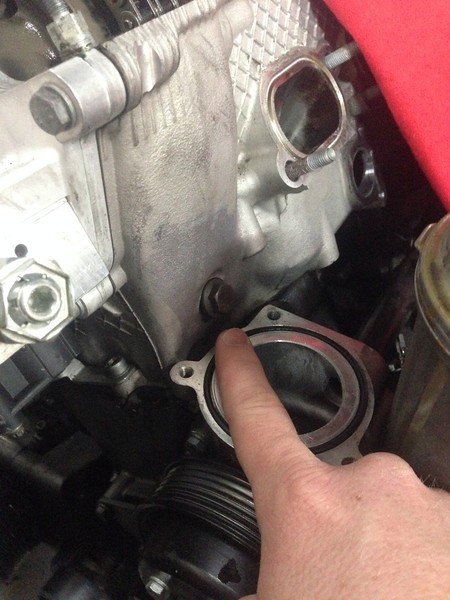

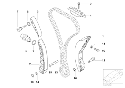

    Have you tightned the timing chain tensioner bolt hidden behind the thermostat? these back themselves out and may cause timing chain noise along with an oil leak

            I don't know if it passed a DIS test - I'll check with the shop. They're a reputable place, I've known the owner for 15 years - they did at least recognize that it wasn't timing chain tensioner
