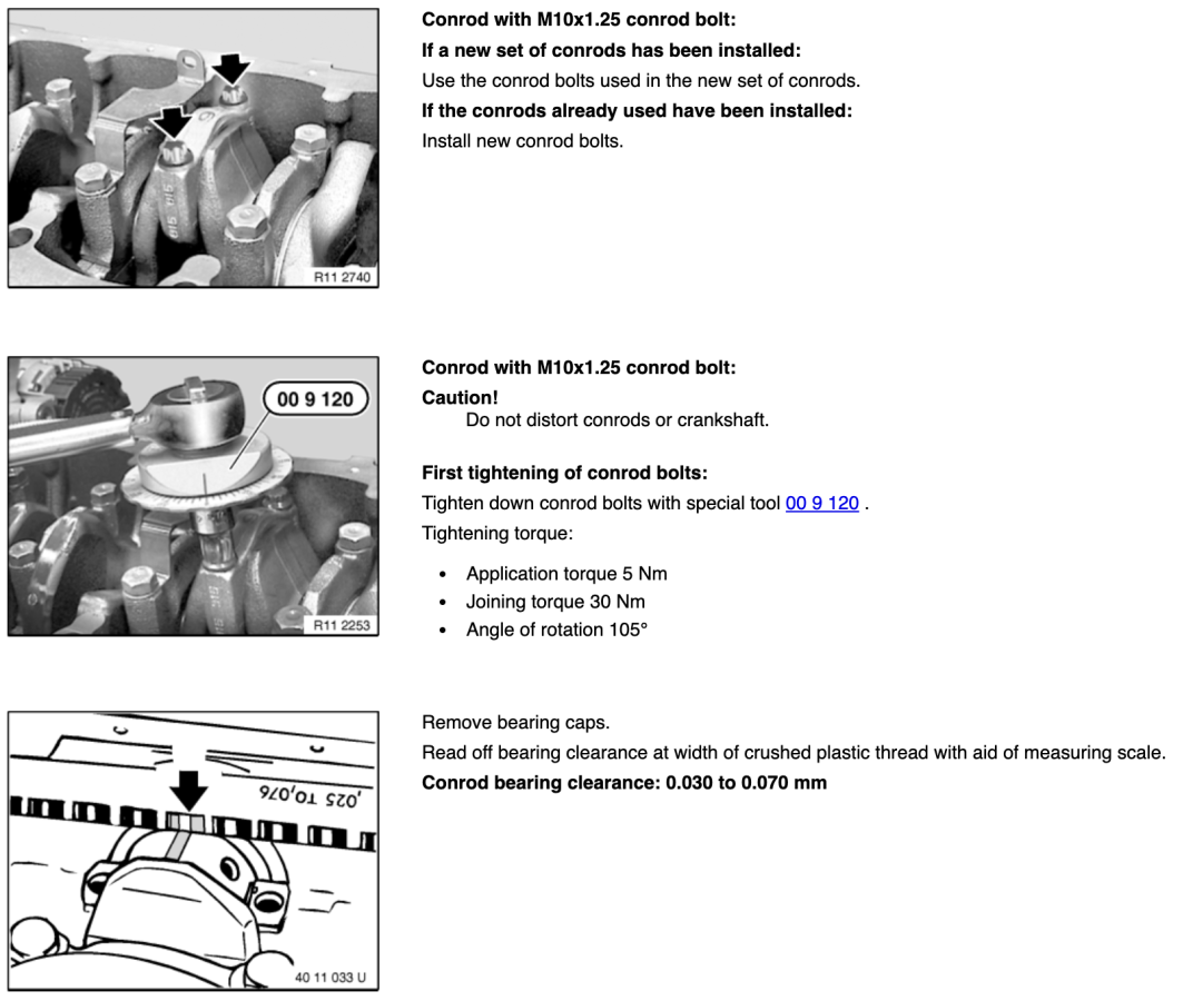

                          So, is the consensus that for '05-'06 models, the ONLY bolts that will work without risk are the OEM?
                            If you use ARP, you need to make sure they torque to yield spec, not just torque, as indicated, the M10 bolts are for the S50 engine, and one could argue they are similar enough on the bottom end design that the S50 bolts can be used on the S54, but you need to torque the bolt to it's stretch spec, not just the generic torque. All this tells me the shop does not know what they are doing, walk away!
                              I remember remember them mentioning yield spec unprompted last week, but i'll be sure that's what they do. I am not certain that the fault is on the shop, especially given that the particular batch of BE bearings is now known to be faulty. I'm getting an 'upgrade' of sorts out of it, so for now I'm okay. We'll see what things look like when the pan comes off.
                                Unsolicited opinion incoming, but I would personally stick to the OE bolts. I wouldn't trust anyone who tells you that the S50 bolts work on the S54 unless they have documentation of installing them on a rod (that's out of the engine) and measuring the roundness of the bore.
                                The torque sequence for the OE bolts is tedious, but not exactly hard. Any decent mechanic should be able to follow the sequence without issue...
