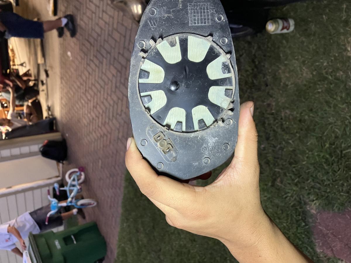

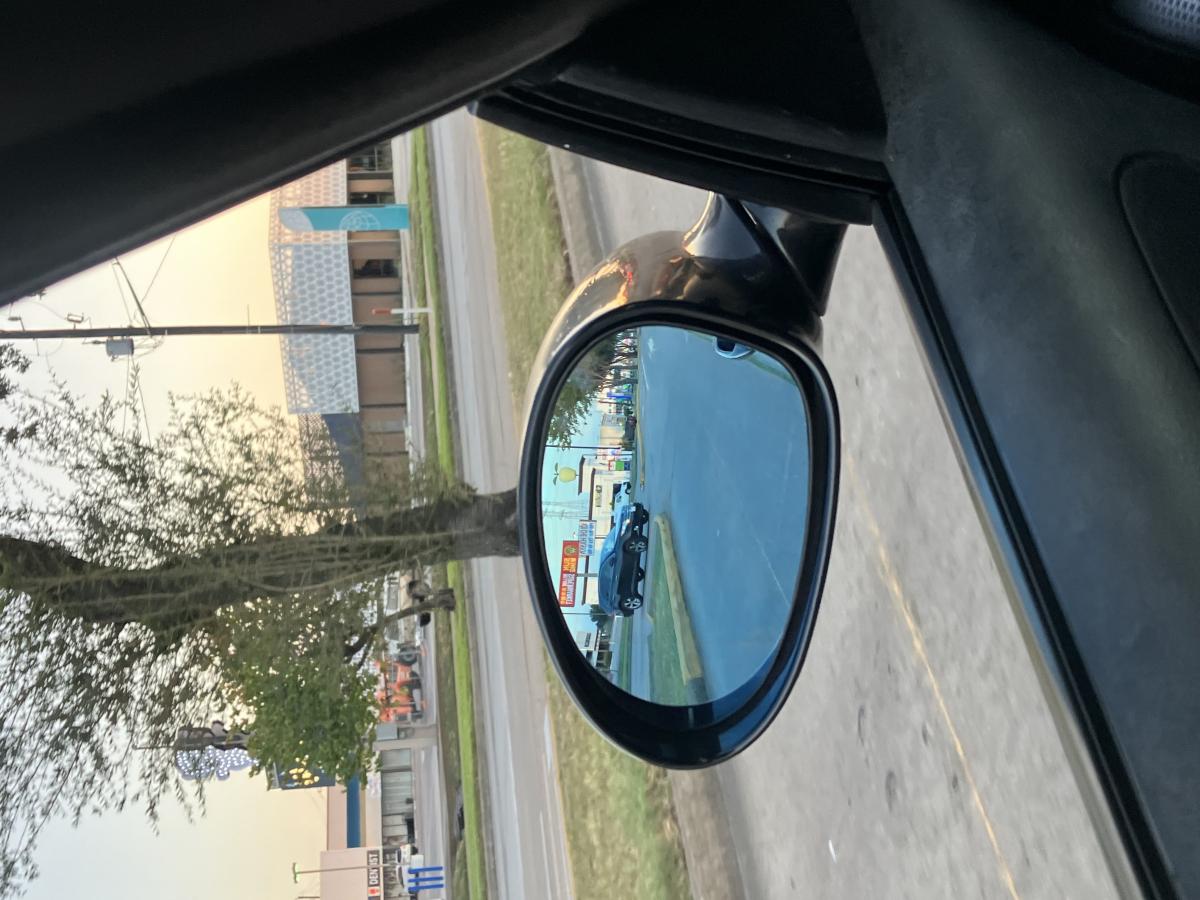

    Pleased so far, should make hoping between cars a lot easier for me as the mirror is what I am used to from my E28.
    For $20, I am not complaining. Installed like the original, no issues.

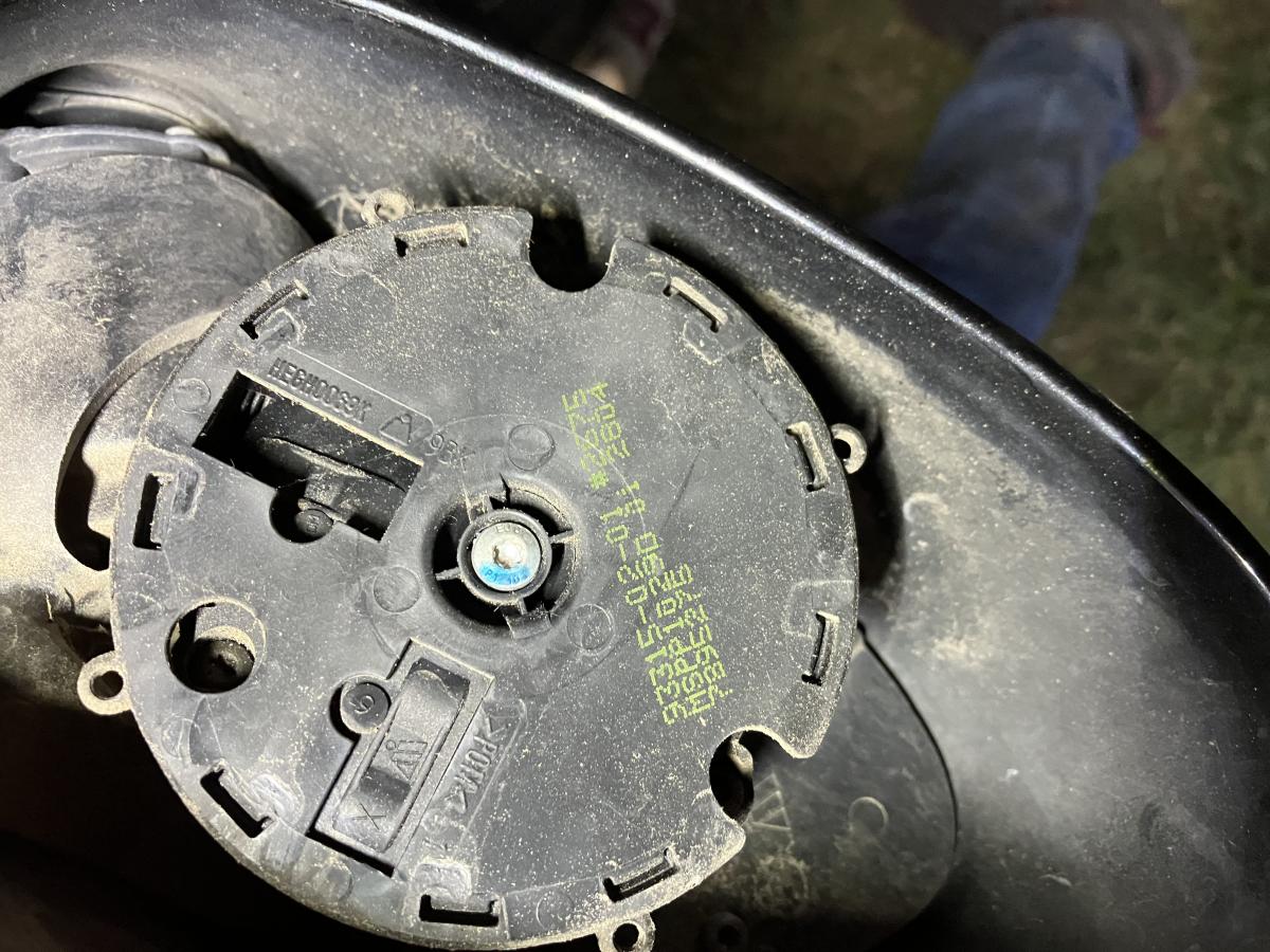

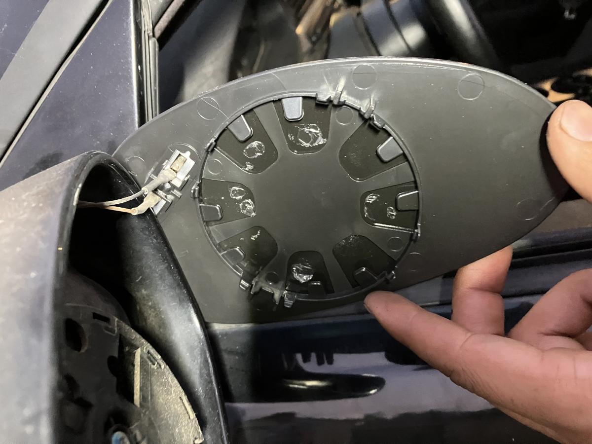

    Original Author Credit - Cooter From - M3Forum Dino's Add-on - This DIY is more geared towards production date cars up to 07/2004. For later models it's quite a lot simpler. Tilt the glass all the way forward so you can get your fingers behind it, apply even pressure towards you and pop the glass out. You won't need the wire
