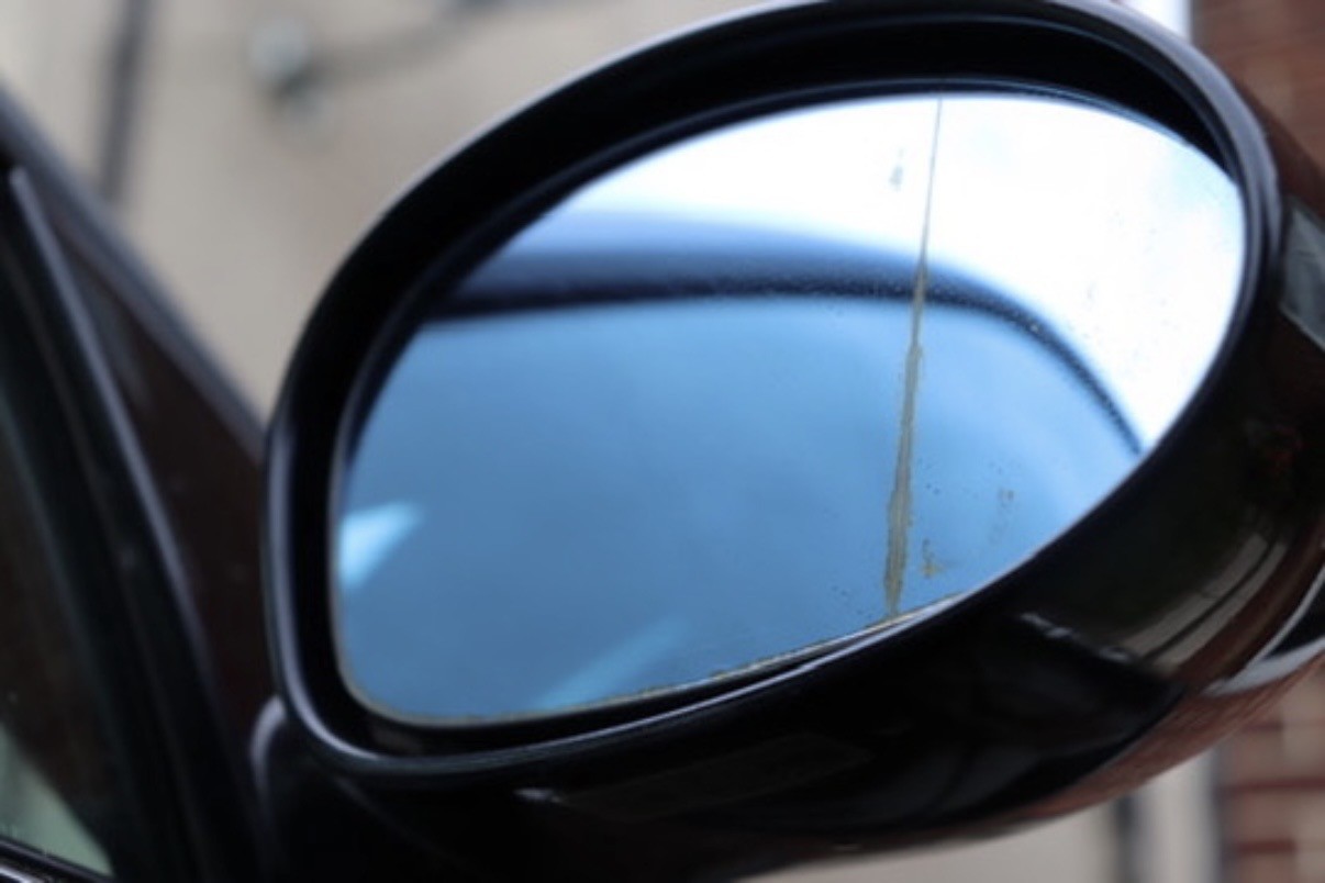

      You know with the genuine BMW wing mirror glass the demarcation line goes brown over time right?​
      Click image for larger version  Name:	IMG_4970.jpg Views:	0 Size:	90.3 KB ID:	571572
      Mirror John makes a set which addresses this problem.
      I’ve had them on my car for over six years and they still look fresh.
      Click image for larger version  Name:	IMG_4971.jpg Views:	0 Size:	149.6 KB ID:	571573
      He also makes replacement rear view mirrors which don’t leak. Have a look at his website: https://mirrorjohn.com
