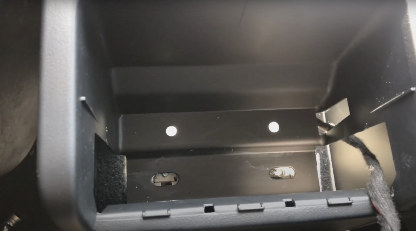

            Sorry to report but i found no adjustment of sorts. Upon removing the ashtray (i have an armrest)
                Huh, I thought I remembered seeing multiple holes below the rear ashtray for the screws to go through, but I might just be misremembering. Sorry about that.
                The short center console is definitely slotted though:

                Maybe you could make your own slots? Although, now that I think about it, you would need to find a way to move the armrest along with the center console.
                  Fixed the issue. You simply pull the back of the center console towards the driver side. Took some pressure but it moved a good amount.
                    after undoing the screws discussed earlier? weird, mine had like no wiggle room- i was pulling on it hard enough to feel like i was about to break it
                      No, I simply pulled on it. Maybe I should go and try to tighten those screws so it won’t move back
