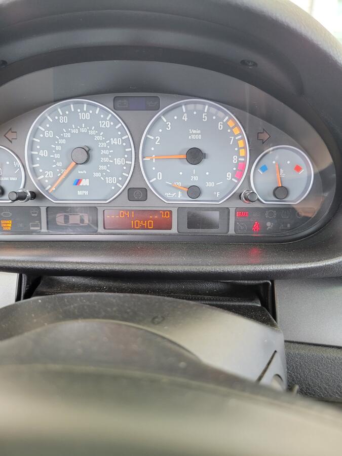

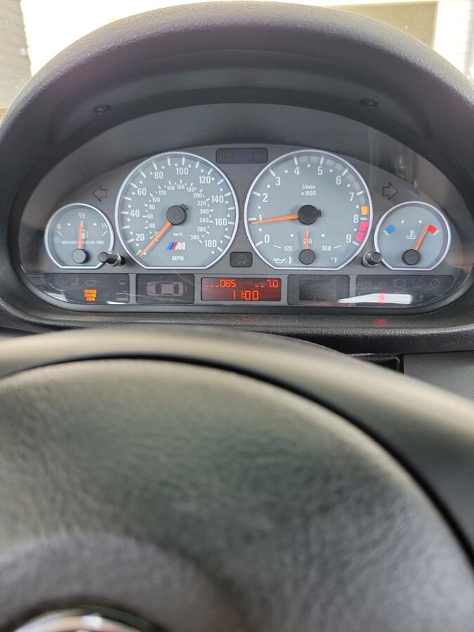

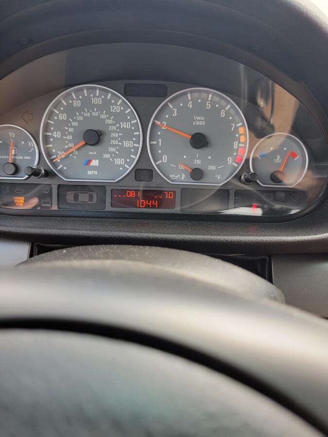

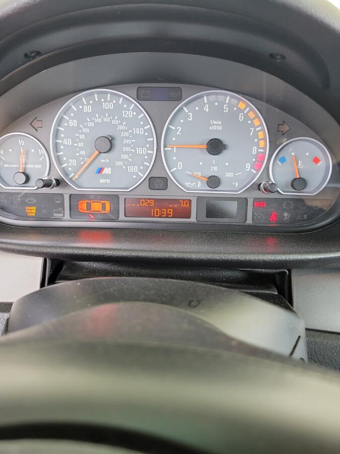

    Tried that method. With car off it was a little under 1/4th mark. Once started it jumped to 1/4 at 29 degrees. Rose to 65 in 3 minutes. After about 5 minutes it was up to 81. This was all in 79 ambient outside temperature. I went on a drive and it never went above 86 on a couple of hard pulls. It's not the heat of the day in Texas today though, it's usually 90+ degrees outside here.

      I assume the numbers are Celcius. Converted it to Fahrenheit and it makes sense 85C = 185F which seems reasonable. I'd say the gauge needs fix

        Coolant=29C = 84F and ambient = 79F. Wonder if 5 degrees diff is due to sensors or engine still warm even resting overnight.
        The pics show the gauge is bad.

            I don't think this has been clarified. In the second pic in the first post it shows the ignition off with the guage near the first dot. If this is dead cold then the cluster must be broken or the needle is misaligned.

                The hidden displayed temp value and the gauge both use the sensing data from the sensor on the hard pipe under the intake, rear of the pump. From the pic showing the displayed 85F-ish while the gauge was over the middle. This means the sensor is OK but the gauge is out of calibration.

                          Edit: wait, I just read through the post again (and looked at the pics) and the needle isn't all the way to left with the car completely off? You should really disassemble your cluster and make sure that the needle is physically aligned correctly before spending any money on anything else. The second link I posted is a good reference for how to disassemble and reassemble the cluster.

                                Yea with the car completely off it stays around the 1/4 marker or a little below. It just started happening one day.
