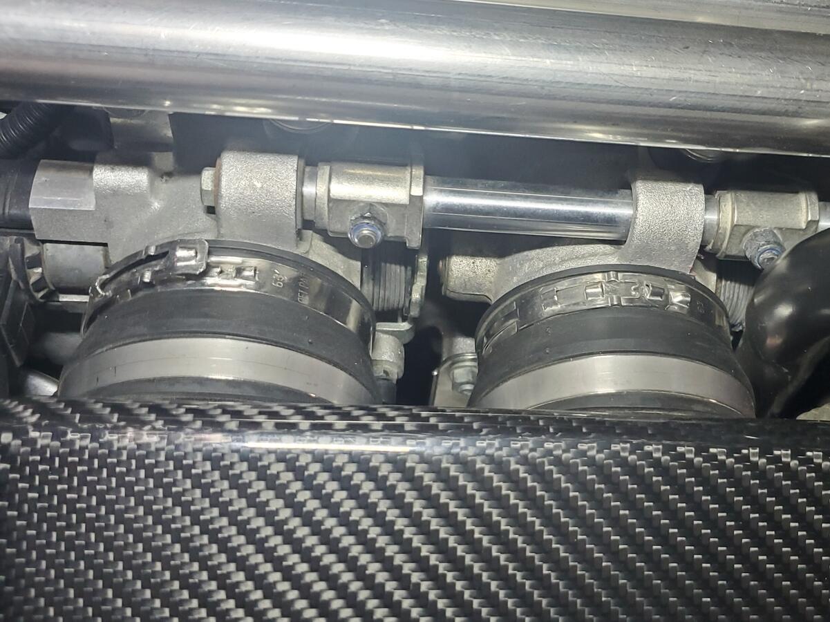

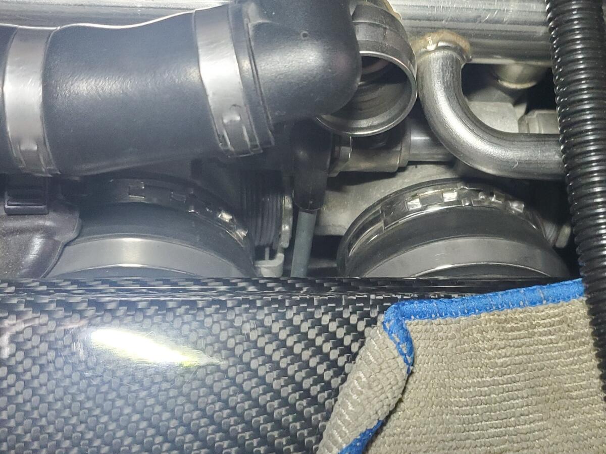

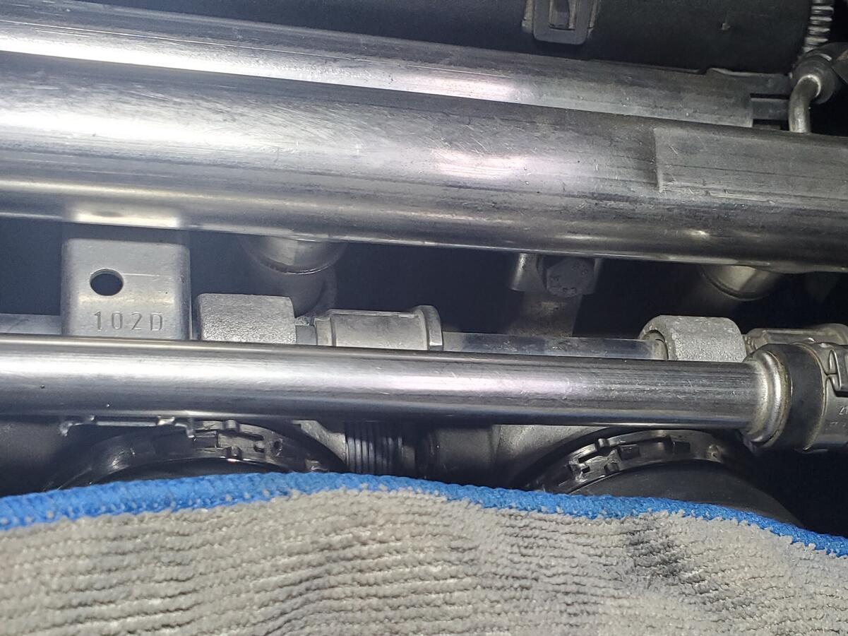

    Additionally, I've found that clocking the clamps in the following fashion will give the best access for the next time they need to come off. No need to remove the fuel or air rails if they're clocked like this. It does help to disconnect the idle air valve connector and move it out of the way, though.
    Cylinders 1 and 2:
    Click image for larger version  Name:	20210711_164518~2.jpg Views:	206 Size:	151.8 KB ID:	118098
    Cylinders 3 and 4:
    Click image for larger version  Name:	20210711_164515~2.jpg Views:	172 Size:	155.5 KB ID:	118099
    Cylinders 5 and 6:
    Click image for larger version  Name:	20210711_164526~2.jpg Views:	175 Size:	151.0 KB ID:	118100
    Note: Cylinder 6 clamp is on backwards compared to the others. I've found it makes it easier to get on and off.

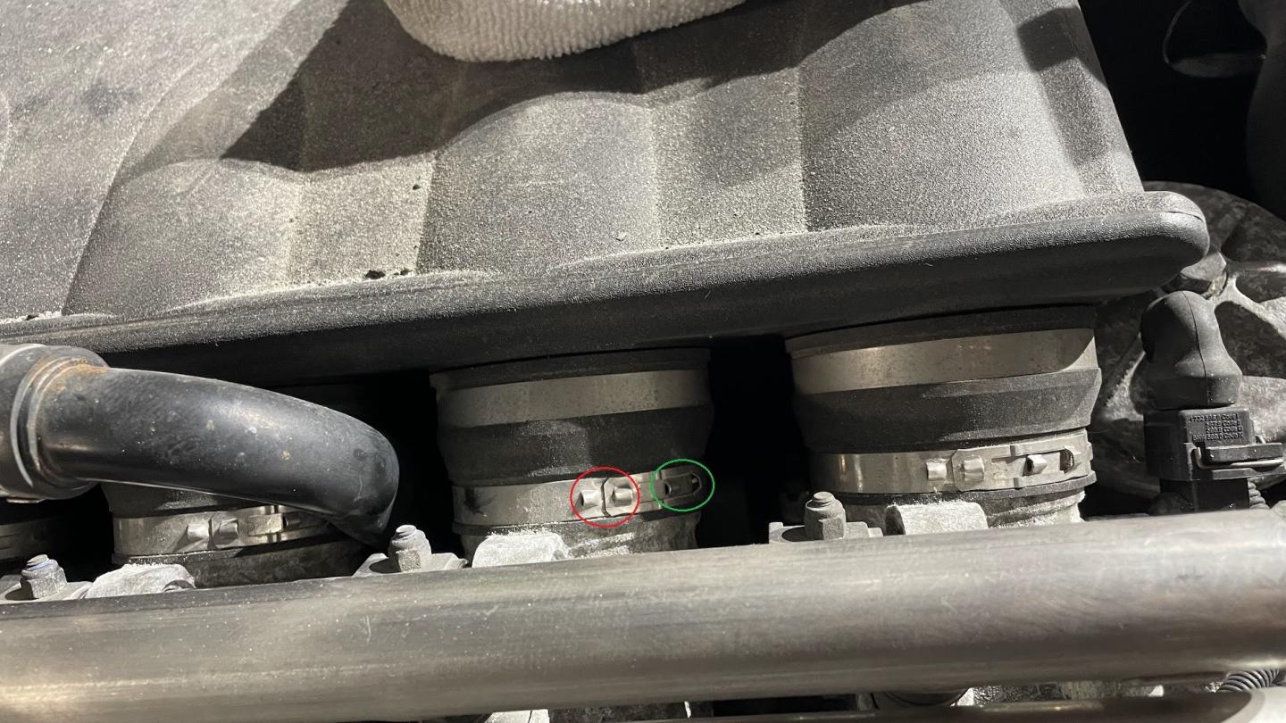

            PSA - don't make the same mistake I did when reinstalling these. Back in 2017, I had the correct pliers and easily removed and reinstalled the stock clamps from the factory positions when I cleaned my stuck throttle bodies. But when I went to remove them again last night, the same pliers could no longer reach the release points on most of the clamps. My mistake was installing with the pliers on the holes circled in red instead of the ones in green (the ones used to release). At the time I thought I was being smart not needing to push the clamps down with my finger while using the pliers with my other hand, but this left the release points clocked over, just out of reach. It took a lot of time and swearing using different pliers and other tools on each clamp to get to finally get 4 of them off without damage. I noticed one of them was already unclamped (I guess I didn't clamp it properly, which worked out for me), but the last one closest to the firewall has been impossible to reach with anything I have. So I gave up in frustration before I tried to use something that would cause irreparable damage (gas and a match). For some reason I had it in my mind that these clamps were unobtanium now, but I see that they're still available and only a few bucks, so I'm just going to pry the last one off with a screwdriver and be done with it.
