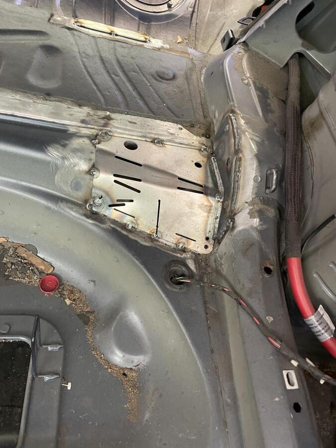

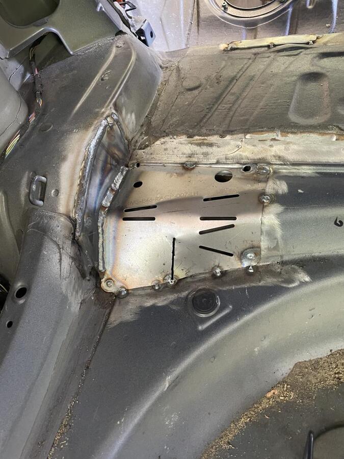

      Waited for my welder to show for about a month, but he completed the job this weekend. Here is a picture of how the "V3" differs from the v2. It directly connects the chassis leg to the RACP. The part that is just tacked is a cover and not structural.
        Click image for larger version Name:	image1.jpg Views:	0 Size:	87.9 KB ID:	125077 Click image for larger version Name:	image0.jpg Views:	0 Size:	99.2 KB ID:	125078

                            What does the bar really do differently than this in terms of racp movement? If you really wanted a bar you could easily weld a pice of metal to both of these plates.
                              #59
                              Vincebar and CMP both require you to drill up through the rear subframe mounts and relace the subframe bolts with extended studs. These studs then bolts to the bar, so that the rear of the subframe is directly bolted to the bar.
                              Similar thing is done for the front mounts with the gusset cups.
                                #60
                                Originally posted by ClevoCapri View Post
                                He welded plates from the chassis rail to the RACP in the boot floor. That is a reinforement. Not as hardcore as a bar then welded between the plates and tied into the RACP but it is definately an improvement.
                                My bad. Yes, its a similar topside reinforcement concept to the CMP Rail Plates
