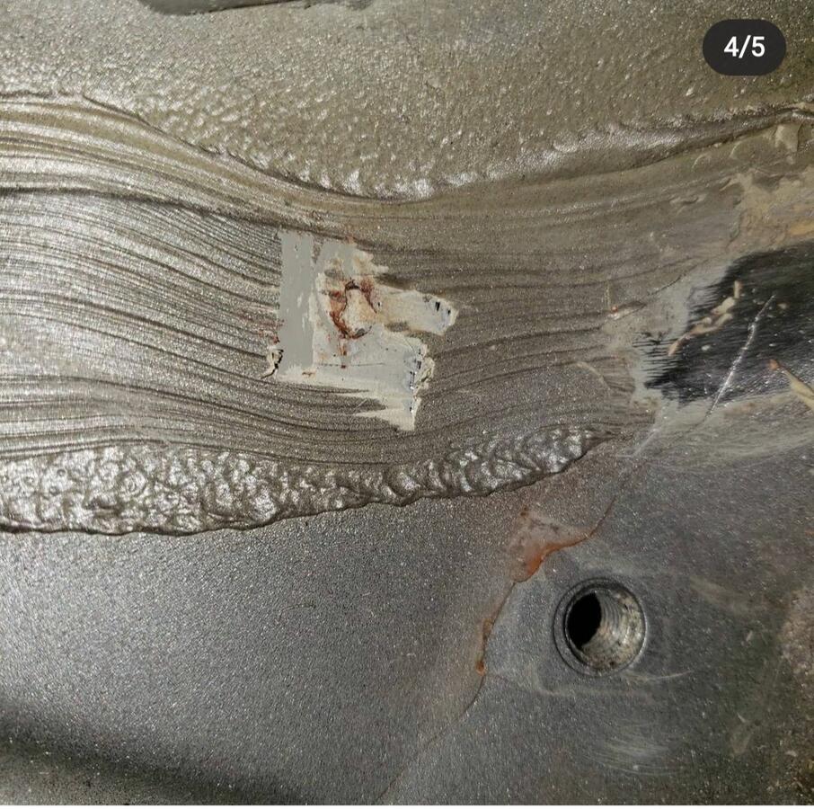

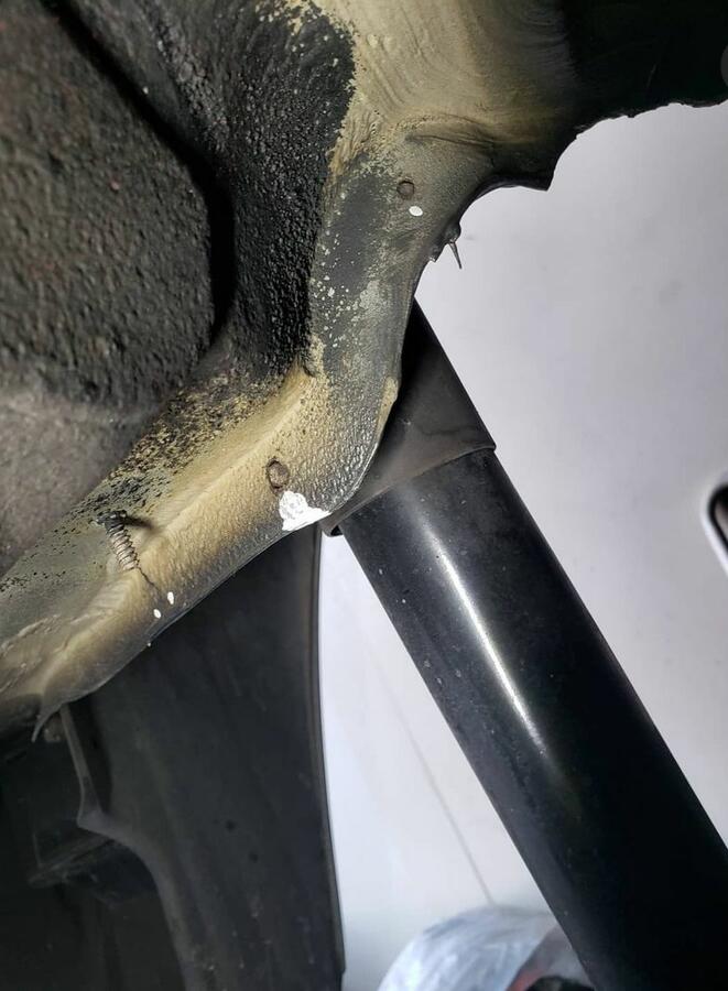

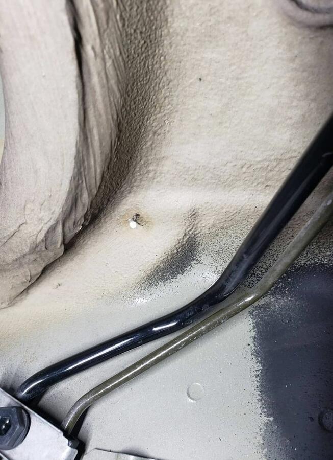

                Triple check that drivers rear mount, drivers side wheel arch seam and spot welds in that area. I'd be surprised if those are not an issue as well.
                Just to add, I don't think many people know how much of an issue this is on the e46 chassis so here's some pics of mine when I did my vincebar after bottom plates were already added. Failed spot welds that are almost un-noticeable or hidden under seam sealer. My subframe mount cracks were much smaller than yours too. The right way is to take off all the seam sealer where George mentioned because the stress will transfer to panel edges will pull down on the RACP at the edges due to weak design. I drilled, fill-weld the failed spot welds and stitch welded the seams of the RACP at the trunk and wheel wells in addition to the vincebar. Pretty labor intensive but I recommend doing this when doing your rear RACP reinforcement. This is my interpretation of true reinforced RACP.
