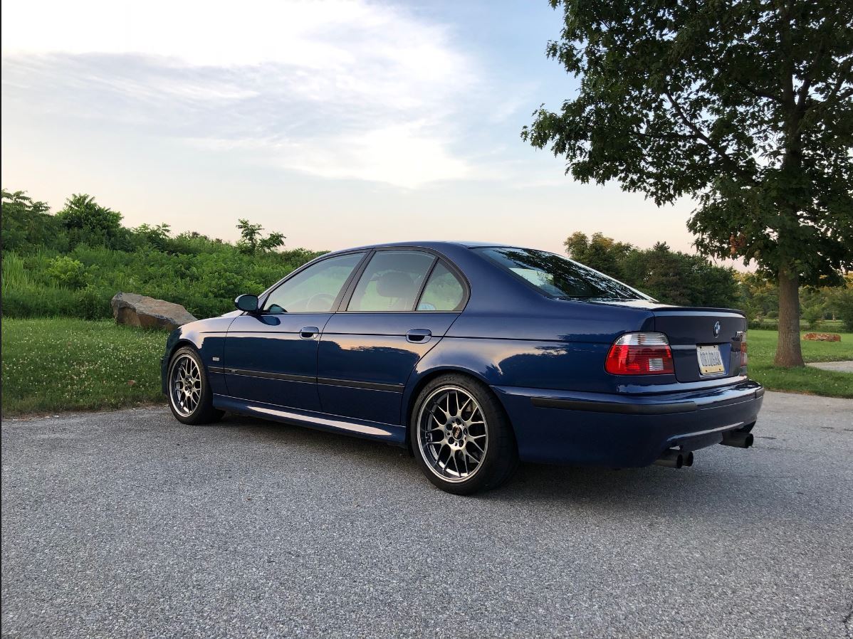

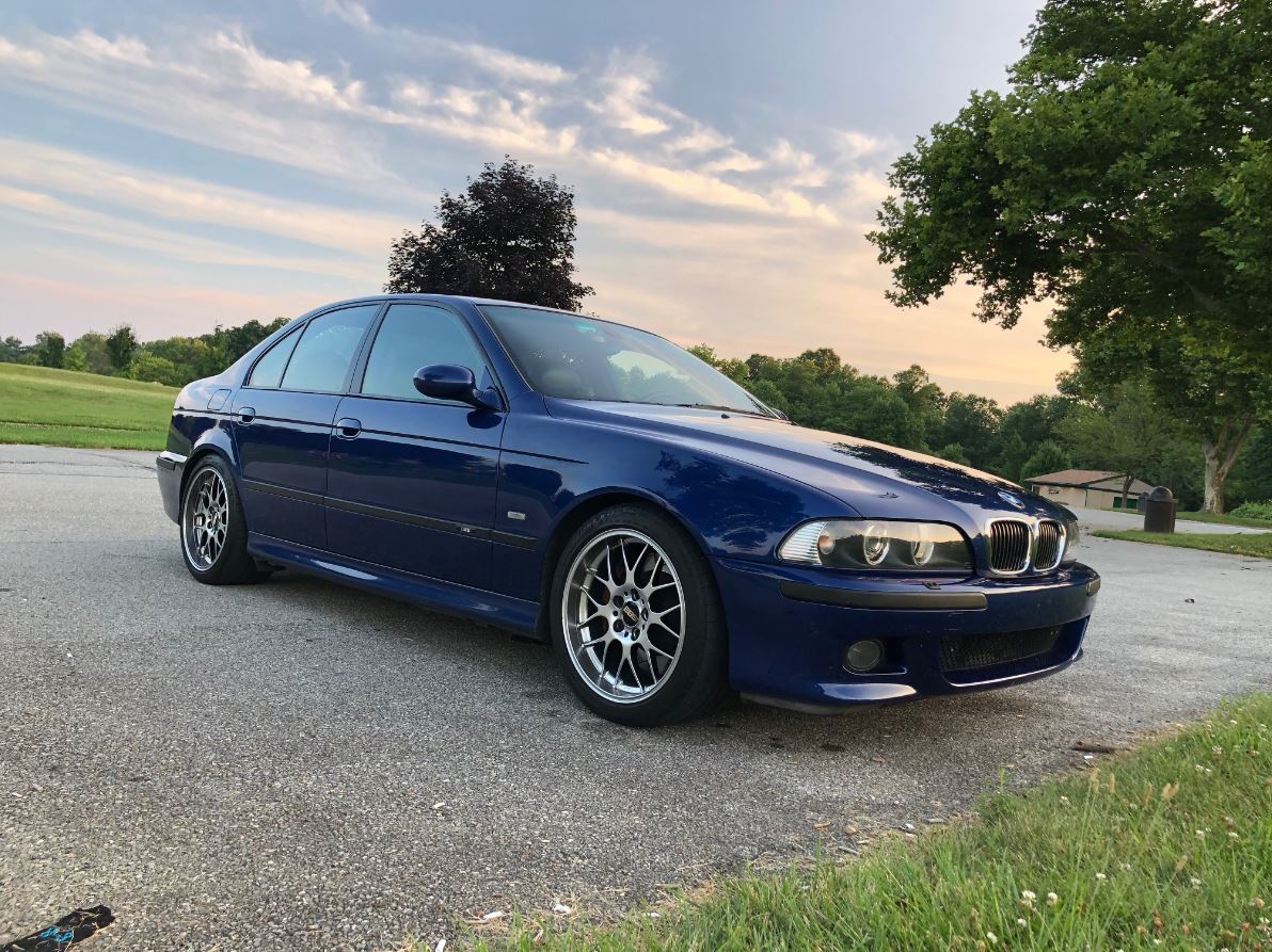

              BBS is hard to beat. I'm running 17" RG-Rs on the M3 wagon (16 lbs front, 17 lbs rear), I used to run 18" RG-Rs on the M3 wagon (until I was able to find a set of 17s), I'm running 18" RG-Rs on the M5 (18 lbs front, 19 lbs rear), and, 10+ years ago, before I knew better (about 19s), I ran 19" RG-Rs on the M3. They're light, they're crazy strong, and not stupidly expensive. 8000+ ton forged in Japan, and thoroughly tested/certified.
              That said, pick 2 still applies (light, cheap, well made)-- BBS's forged wheels are absolutely in the light/well made category.
              Click image for larger version  Name:	6.JPG Views:	0 Size:	253.4 KB ID:	119775
