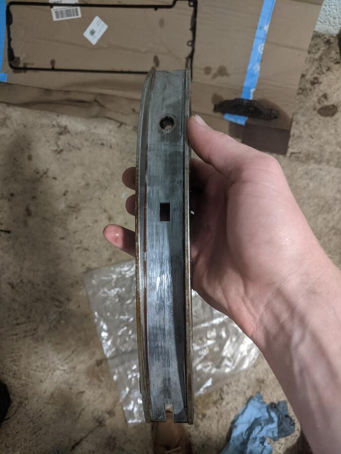

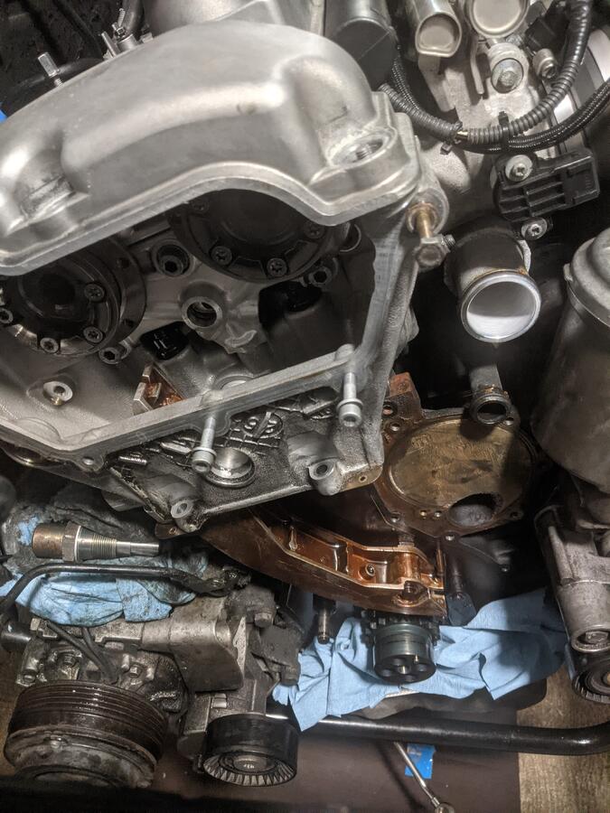

              Been a minute here, but I was able to get that guide out! I'll be honest, I wasn't sure I was going to be able to, there just isn't much room there, even with the other guide removed:
              Click image for larger version  Name:	PXL_20210921_023235760.jpg Views:	0 Size:	99.7 KB ID:	127913
              I ended up needing to remove the bolt and the guide together. It put a little bit of strain on the bolt as it was coming out, we'll see what it's like going back in, but there was no way the guide was going to slip over the long end of that pivot there. heinzboehmer, I know you thought you put the bolt in first, then the guide second, but I saw no way that was possible 🤷‍♀️ Either way, appreciate your guidance and happy to have it out!
              Click image for larger version  Name:	PXL_20210922_003232712.jpg Views:	0 Size:	64.7 KB ID:	127914
              Still not a given that this is the main source of the metal, but this aluminum guide was definitely getting chewed up. Next steps are to put in all new guides, chains, etc, get this part of the motor back together, then check rod bearings.
              Also the handle on my brand new OE cam tool pin pulled right off the first time I used it 🤔

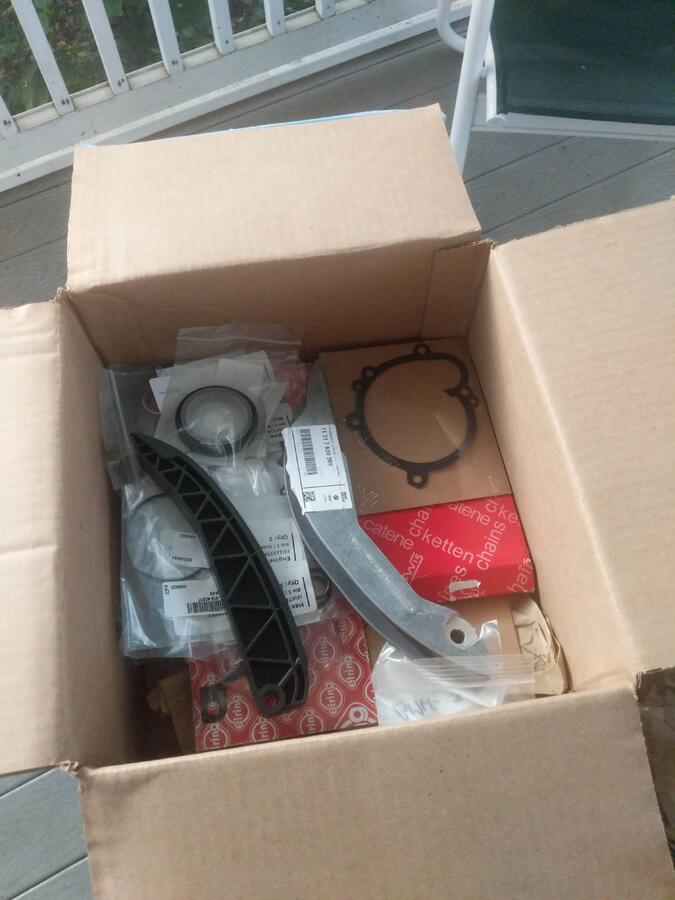

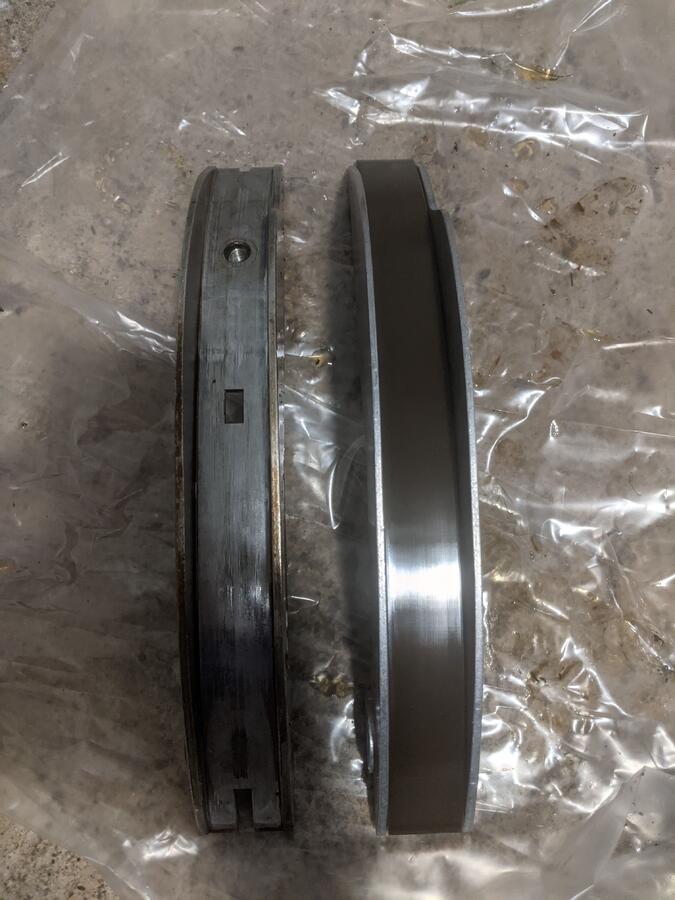

                              Two weeks delivery time on these parts 😫 but they're here now!
                              Right, that's how that guide is supposed to look.

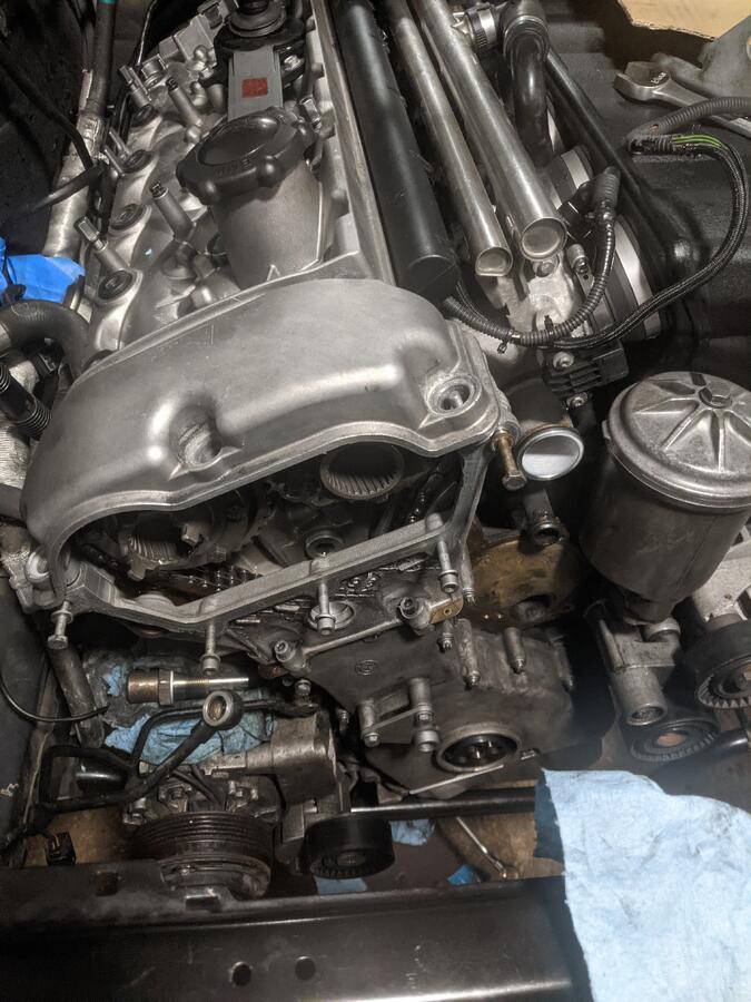

                              Got the new chain and guides on, also got the timing cover bolted back up. Next step installing the front crank seal! Not looking forward to it, but I'm going to try the solo cup method along with a piece of wood drilled out for the crank bolts.
