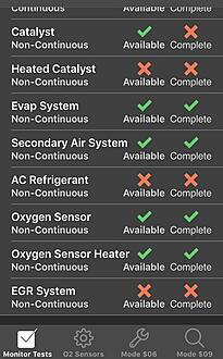

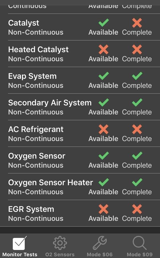

                      The “drive cycles” usually set the monitors. Often done when not triggering or cleared recently.
                      Unable to communicating to/through the port is different (if that’s what test station said was reason). For instance your monitors could all be triggered and set but if unable to communicate the test can’t read this.
                      Here is my old OBD Fusion reader when my cats weren’t setting. I had to do drive cycles to finally trigger. *of note AZ might check less monitors, this is just an example
