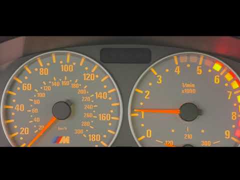

    My e46 m3 has been hesitating on cold starts (please watch the VIDEO), the rpm's jump several times to the correct rpm rather then being smooth. The car then idles very smoothly afterwards. I was hoping to get some feedback if anyone has ever seen something similar to that video, or could recommend anything to help solve this issue. The car has roughly 67k miles.
    Also here are some important points
    • The car is throwing no error codes
    • The car starts great when warm (any heat in engine)
    • Car starts every-time when cold on first try (just hesitates usually)
    • Car starts better if it doesn't sit very long, however it can start poorly even when started the next day..
    • Car drives great, no hesitations when driving
    • ICV & throttle bodies cleaned (seems to have had no effect on starting issue)
    • Compression test numbers were even across cylinders (measured warm)
    • Brand NEW Battery
    • Valve adjustment & Vanos rebuilt complete
    • New Spark Plugs
    • New Fuel Filter
    I think this issue is most likely either the Injectors not working optimally, or maybe the fuel pump going bad? I think my best bet is to do a fuel pressure test and see the results. The car does not have any issues other then the cold start.

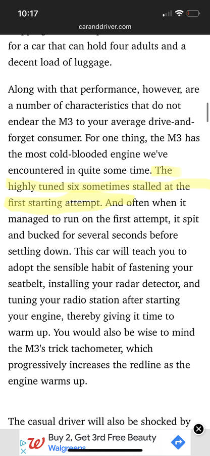

                          I find this very interesting. From a 2001 review by Car and Driver of the E46 M3. It seems that this was happening with brand new examples back in the day.
                              Nice find. Pretty definitively proves that this happened when the cars were new too, in my mind.
