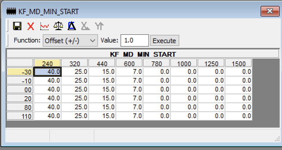

                  I wonder if this map might be part of the issue:
                  US 2701:
Name:	Screen Shot 2021-09-23 at 9.14.01 PM.png
                  Euro 2001 / CSL 0401:
Name:	Screen Shot 2021-09-23 at 9.13.48 PM.png
                  This function describes the amount of torque the DME tries to generate at the specified coolant temp and RPM during the engine start. The columns are RPM, the rows are coolant temperature (in ºC), and the actual table entries are torque (in Nm).
                  Euro / CSL goes 40-25-15-7-0 regardless of temperature. US does 25-25-25 etc at temperatures between 32 and 68 F. Then between 68 and 178 F it will generate something between that 25 and 10 Nm. Maybe that 25 at 240 RPM just isn't cutting it for some motors (There are probably minor variations in friction from engine to engine).
                  My car is running CSL management
